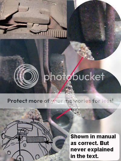

I've worked for 2 hours on this bloody thing. Never had problems like this before - but then again, haven't done shoe brakes in 10 years.
The upper spring on the brake shoes is proving utterly impossible to put on properly. (It doesn't help that I don't have a brake "tool". My Vice Grips won't fit into the tight space so I'm using the old slip the spring hook down the screwdriver into the hole method - which usually works after about 25 tries and associated explosions.) I have the manual which shows I have it right - sort of. The drawing in the manual is so poor its hard to tell for sure. But the side of the spring is pushed up against the Ebrake cam mechanism no matter how I orient it; left to right, right to left this way, that way. It keeps pressing up against the cam. It does look like if I put it behind the shoes, it will clear everything - but huh?
I'm working under less than ideal conditions with less than ideal lift equipment at the moment so would rather figure this out before I get into doing all the things I will have to do in order to take the other side apart to examine it. :roll:

This is weird.
Proper installation of the top shoe brake (parking brake) spring has had me confused during this brake job. (Which is taking FAR too long because of other duties) I consulted the manual after I couldn't see any possible way to install them that made rational sense of the bent area of the spring. The manual does have a drawing, but spring orientation is never mentioned in the text - and the drawing shows it installed opposite my best guess.
While dodging rainstorms, I finally jacked up the whole back axle so I could examine both sides simultaneously. The old side was indeed installed per manual drawing, but it appears to be a flawed design. The photos show both my installation and the factory installation. My installation has the spring clearing all parts. The factory installation has the spring wire extension rubbing up against the parking brake mechanism in two spots - one of which is beginning to carve out a notch in the wire.
I've tried to figure out why on earth they would do this and the only things I can come up with include:
* A support for the parking brake lever.
* Retainer for the parking brake lever. But neither make sense since there is no way that lever mechanism can go anywhere unless it is pulled or the shoes are removed.
* A spring-loaded stop to keep the shoes from drifting up. But this doesn't make much sense either if you closely examine the internal dynamics of the system. And even if it was needed, it seems like a rather silly - if not somewhat dangerous - way of accomplishing the objective.
Does anyone see any reason they would do this? Or is it another one of those "It's a CRD thing, you wouldn't understand"?
Image[/img]
