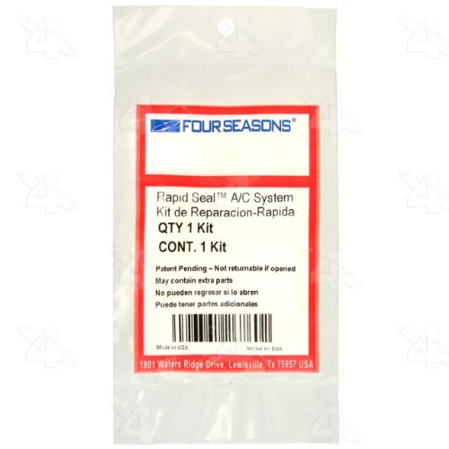

So, if I'm replacing the condenser, are there some specific wear items I should expect to replace (gaskets, seals, fittings, etc.)? I want to avoid as much downtime as possible and pre-order everything (the local shops around me tend to be horribly stocked).
I just ordered one of these off Amazon for the KJ. Hopefully it'll have everything that's needed:
Dan
