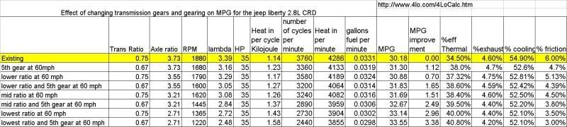

I drive roughly 40 miles a day at 60mph (speedo readout) for my daily commute. at this speed the 545RFE is tuned to be in 4th gear (.75:1 overdrive) this puts the car at 1900RPM for as long. i found that if i speed up to 65mph and slow back down to 60 it will stay in 5th gear (.67:1 overdrive) and about 1700 RPM, 200 RPM less. this is a pretty well known thing, but its right where i run the car.
I think that dropping 200 rpm and increasing the load to make the same power will give the engine about 2% more thermal efficiency, and this should translate to ~1.3 MPG more. classic down-speeding MPG increase.
my question is: is there any economical way to change the shift point on the '06 CRD? i know there are some tune-it-yourself chips coming out that may allow me to tune the shift to my driving style, but they are at a price point that makes it an irrational buy for the money. i would like to pull the 5th gear low-load shift point to 55mph, down from 65mph and the 4th gear low-load shift point to 45mph down from 55mph. i would want the medium load shift points to be left alone, in case i find myself needing to tow anything.
I also looked at the effect of installing 3.55:1 axle gears, and the amounted to only a .5 MPG increase. the gear swap would cost between $1000 for new gears, to as little as the work to swap diff's with a 3.7L gasser who would want the 3.73:1 ratio the CRD has already. given all that trouble, running a more favorable shift point looks like the easiest way to lower cruise RPMs.

this is an excellent piece of info! Thanks for posting. looks like for around $350 of parts, plus ~ $200 supplies, this approach might work. (minus $50-100 resale on the old 3.73 gears) the nice thing about gears compared to a shift pattern change is that the downspeed benefit is at all speeds. and in a jeep so-called highway gears are not going to hurt any of the capability, it has a deep first gear and there is always low range. FYI 3.21:1 gears will give about 260 RPM drop compared to 3.73:1, will crunch the MPG increase tomorrow. plus i have been wanting to put in a trac-loc in my 06, and this would be a great time.
however, depending on the MPG increase it may be less of a deal than the GDE tune, which also is 550. they indicate that they can get 2-3 MPG more with their ecotune. so optimistically that's $185/MPG increase for GDE.

here is the break down for the different gearing scenarios. the 3.21 gears would get about 1.5 MPG more than the 3.73's at 55 MPH (60 speedo)
