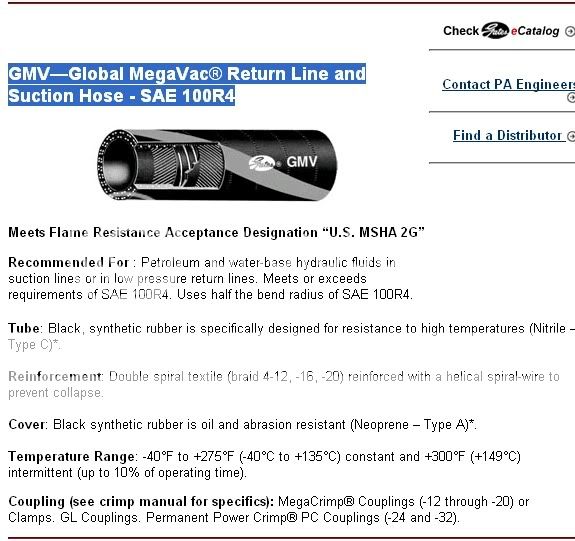

I had my Home Depot Braided hose going to my oil separator collapse and had to shove a coil spring in it to get by.
Now I ordered what I need to do it right.
12GMV MEGAVAC® HOSE
3/4" ID with 2 1/2" minimum bending radius, should work.
Will post pics when I get it installed
One vendor: www.motionindustries.com

This has been brought up before. Do NOT use that see-thru hose you get at Home Depot! When hot, it collapses.
You can get this hydraulic suction hose at any hydraulic shop that makes hoses. Good Stuff.
