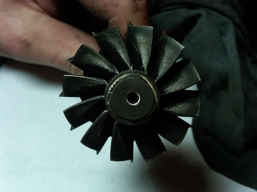

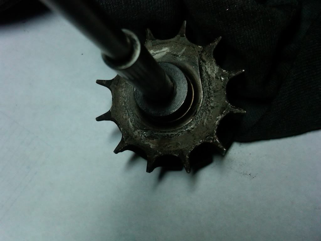

Turbo pics

I can see where the turbine might be dirty if you are running sub-spec Bio, but why does the compressor look like that?

Location: Hillsboro. OR
That is the exhaust side of the turbo. I replaced the boost solenoid but that made no difference. The vacuum canister maintains vacuum fine. When I pull the hose off, if bleeds off vacuum.

Posts: 1766
Oh. I thought you were showing both wheels. There is a boost solenoid and a vacuum solenoid. Did you replace both? Have you compared the MAP signal going to the ECU to your boost gauge?

I did not replace vacuum solenoid. It appears to be a shut off for the whole vacuum system attached to the canister so it does not loose vacuum when engine is off. I am not certain of that. All I know is that there is no shortage of vacuum when it is cold. I have compared the boost pressure to the MAP sensor reading and it is of course one atmosphere higher of a number. Today I noticed that the EGT was 1140F the RPM was 1800 on flat road with my foot barely on the pedal. I was going about 53 MPH. The boost gauge read 19 PSI at the turbo. Normally when I am pulling a 6% grade the EGT only goes to about 950F with the vehicle warm. It sure seems like an excess of fuel is being squirted in when the vehicle is not up to full operating temperature. I can understand a little extra when cold, just seems like too much to me...
I am going to pull the turbo apart again and clean the fin area with a caustic solution so I know that out of balance will not be an issue. I only cleaned the back side because I was afraid I would damage the fins. Since then I have learned that I can boil the unit in a caustic solution instead of scrubbing and picking...

Posts: 1766
Solve the overfueling problem first. Once that's done, the turbine should take care of itself. 1140F will burn off all deposits in a short time as long as you are not adding new by overfueling.
