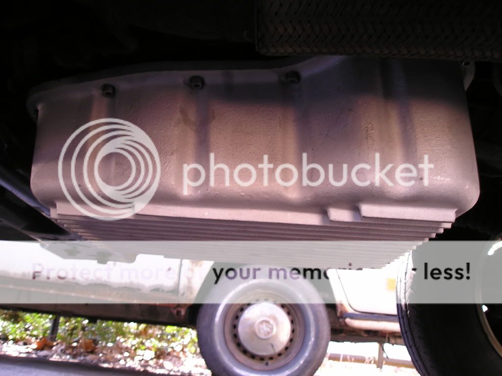

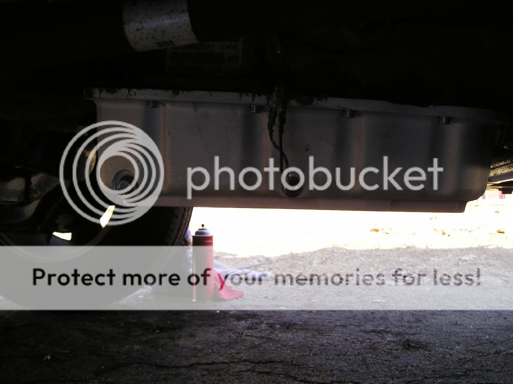

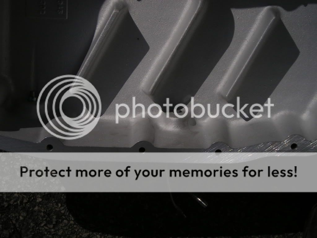

My Extra Deep PML Pan:
Left View including temp probe:
Probe location:
Right View:
How much it hangs down:
The PML Extra Deep pan keeps my Trans Temp nice and cool, even when towing. The warmest my Trans Temp ever got was 180 f when I was stuck in a traffic jam and it was 96 f in the shade. When ever I start moving at least 45 mph even when towing, the Trans Temp drops.
