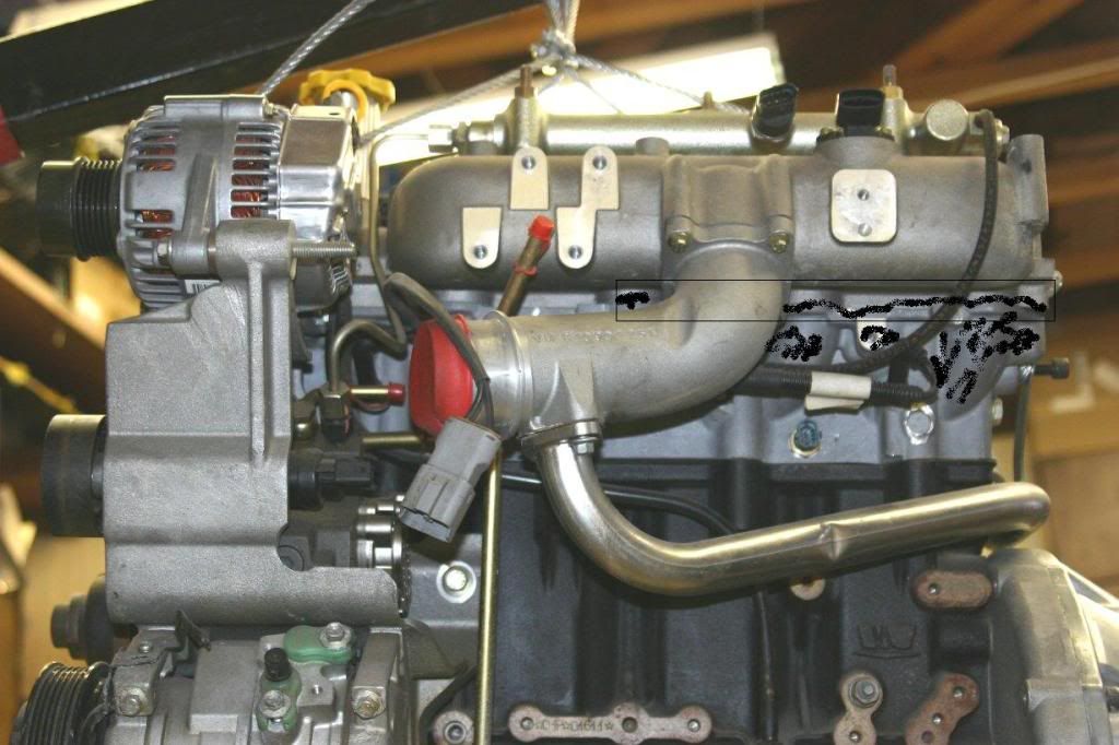

Looking through my photos this is about the best picture I can find of that area, you can see the cast block meeting the head, and above that the meeting of the aluminum intake with the aluminum head. I think to be getting oil on your glow-plugs you would have to be leaking from the valve/intake gasket.

Awesome pic. I will edit pic and show where oil is pooling.. Thanks!

I don't see where the intake gasket would be...can you highlight it? Is pulling intake a job a person with average mechanic ability can do? (I've pulled engines, replaced tranny's on other vehicles but diesels scare me with all of their plumbing etc...

If its in that area then it really does seem like the intake gasket.
Here is another pic, maybe you can see the difference between the head and the intake here.
The only other thing it might be are those plugs at the back of the intake/cam area.

maybe this will help some more:

Thanks, the pictures sure did clear things up. I agree its the "valve cover gasket" that is leaking and possibly those cam plugs. Regardless, having the cam built into the intake means its a job that I don't have the special tooks to tackle. Am I correct to say that removing the intake assembly means camshft is also removed? Timing belt needs to be removed too to remove intake? If so, I might as well get new timing belt, new water pump, rollers, tensioners, etc..etc...

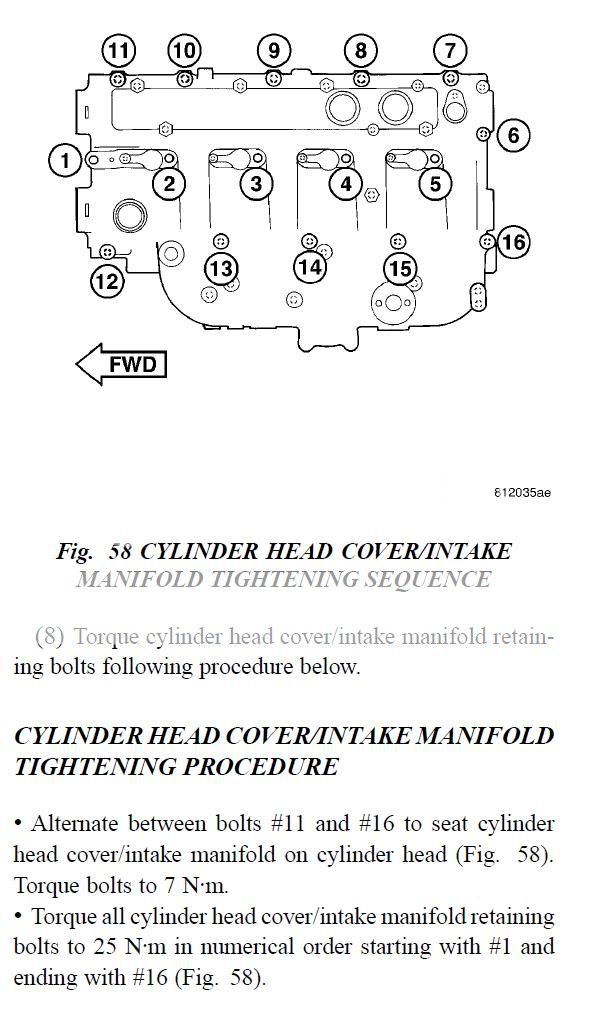

Since you mentioned it stopped leaking while on a trip last summer then restarted would it be possible that just retorquing the bolts would stop/slow down the leak? "Assuming" the bolts are out in the open it might be something to try.
Joe
 Post subject: Re: Oil Leak, is this the end for me? Advice desperately needed
PostPosted: Thu Feb 04, 2010 9:46 am
Posts: 1111
There are 16 10mm bolts that hold the intake manifold in place. The picture below shows where they are and the torque spec. Checking these may provide an easy cure to your issue...hopefully! The circular torque procedure is not the best in our opinion, a criss-cross pattern would provide a more even torque. Since the side leaking on yours are teh last bolt torqued, maybe they have relaxed over time and just need a good snugging up.

Drewd, what Joe and green diesel said, retorquing the bolts should be the first step. Then powerwash the top of the engine with a little gunk engine cleaner is in order. Also check the CCV puck on the back of the head to be sure that isn't the problem, another easy fix.

I'll check torque and tighten as necessary all of the bolts on the intake manifold this weekend. Should I break torque and retighten them or simply tighten them up. I'm hoping this is a cure or improves things a bit. I can honestly say I will never buy another Jeep product unless Chrysler takes significant steps to improve overall quality. Life pump, fuel filter head, provent CCV etc..etc.. and now this for a 4 year old vehicle is not acceptable in my opinion. Shoot, my VW TDI's were more reliable than our Jeep Liberty CRD. I, of course, say this after i got an 07 GC CRD in the driveway :-) Why can't Honda or Nissan bring over a diesel SUV?

It does sound like you have a loose intake stud, I would break them loose and then go back in and torque them properly, one by one. Don't loosen them all at once, or the seal really WILL be un-done.
