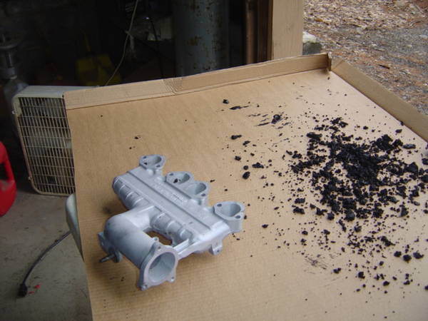

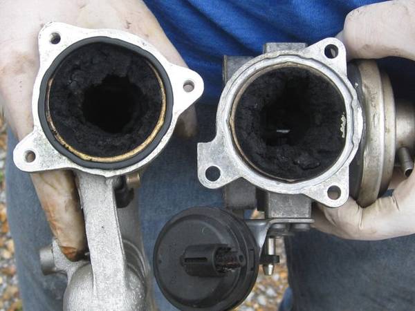

This is how your intake could look if you left the EGR enabled, and allowed oil to mix with it. With the SEGR you should be just fine. This is from a VW TDI, they were notorious for this problem. You either got to stop the oil or the EGR. My last TDI had no EGR, I replaced it with a Dieselgeek race pipe.
Here is my VW manifold after I chemically cleaned it.
Images not visible, says it's for TDIClub members only. I am interested to see them, can you put the images on photobucket or something and repost?

PostPosted: Fri Feb 19, 2010 7:26 pm
Posts: 2543
Location: America
Ok, pics on Photobucket.
