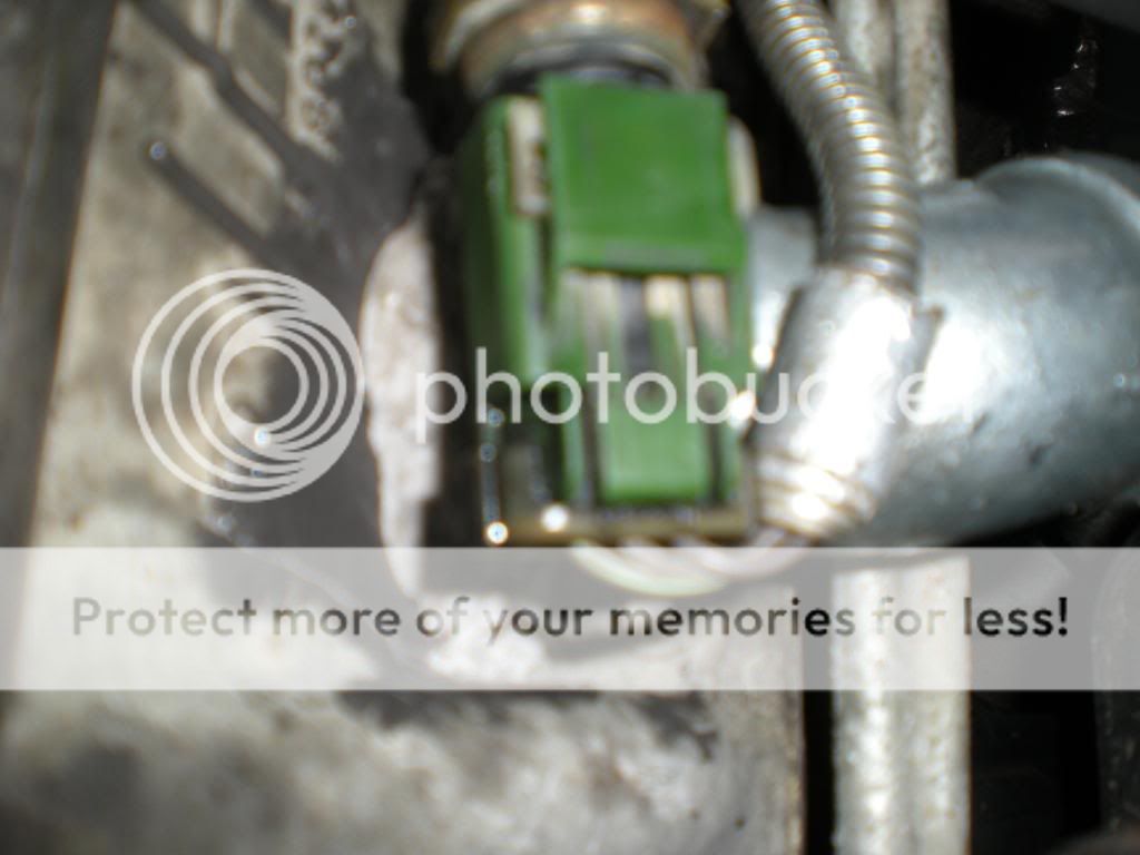

I have added a Centrifuge to my CRD to keep the oil clean. After over 100 miles my oil is medium brown in color and not black. I mounted the Centrifuge onto an aluminum pipe flange.

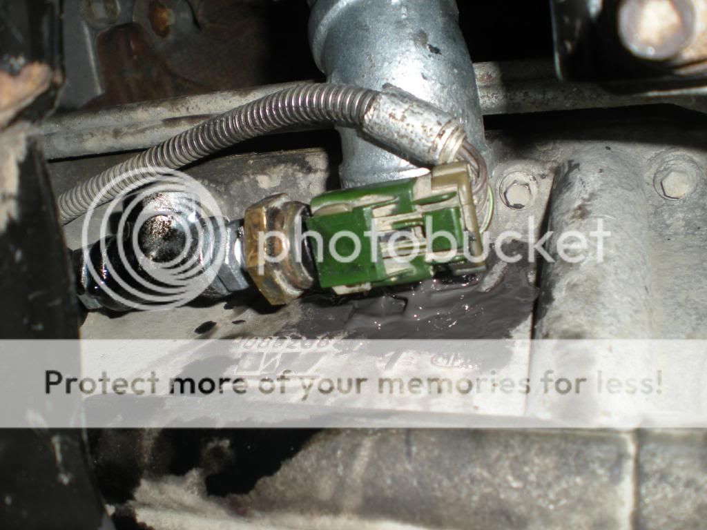

To make room under where I wanted to mount the Centrifuge, I had to move the Wiring Harness plugs near the TCM so I modified the bracket.
Plugs toward engine were moved 1" toward fender and 1" toward fire wall.

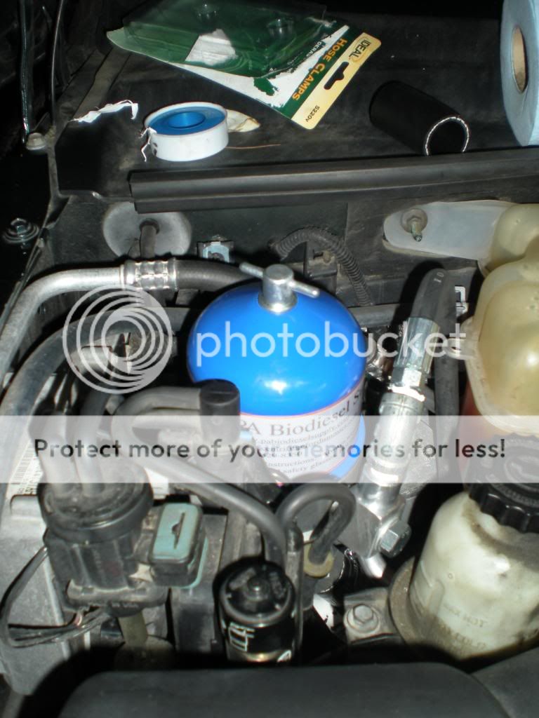

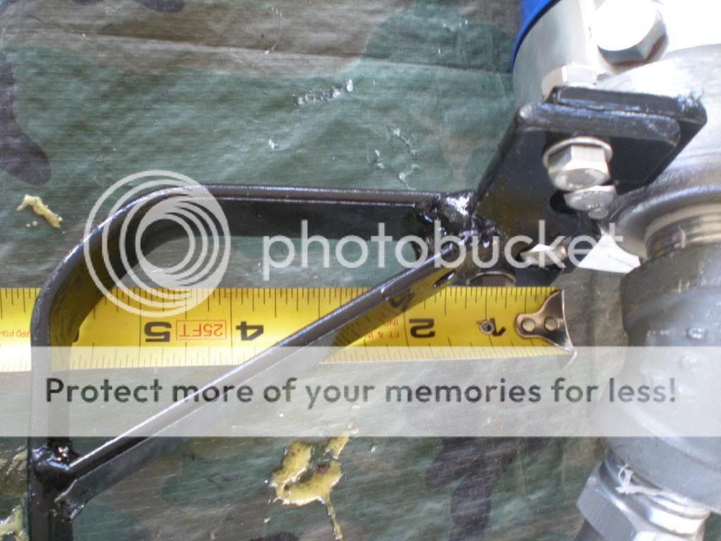

Centrifuge mounting racket that bolts to two bolts on fire wall that hold reciever dryer.

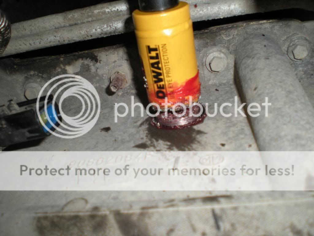

Cut hole in side of oil pan with hole saw turned with ratchet, note grease on hole saw to check chips.

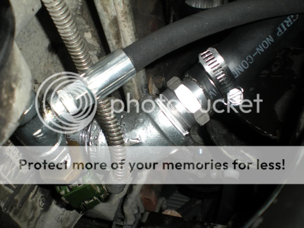

Drain and oil supply line mounted.
Conduit nut and JB Weld used to strengthen fitting in oil pan.
Epoxie Putty used to reinforce fitting more.
InstalledImage

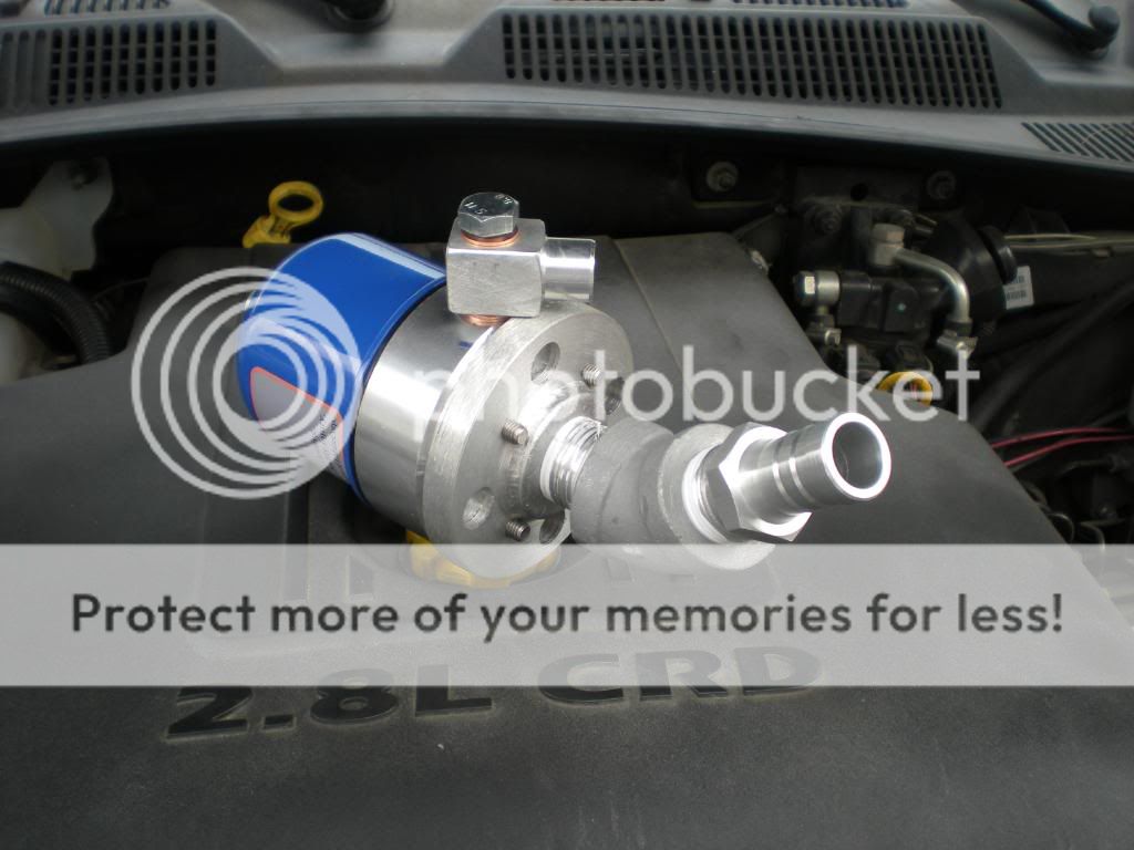

Centrifuge with cover removed.Image
Specs.
I plan to change the oil feed line plumbing by getting rid of the Banjo fitting and add a union.
