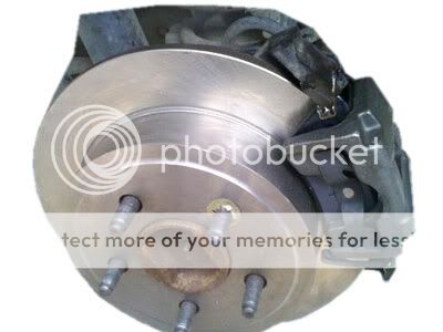

Just did mine last summer. They wear out faster than the fronts - very strange. I also had to replace the calipers since they were corroded to beat hell - which I think may have contributed to dragging which in turn would have made them wear out faster. The current all new brakes do not get warm on the highway and don't seem to grab as much, so I assume it's no longer a problem.
A couple things I found frustrating:
Nice and shiny - and better than Chrysler new:
