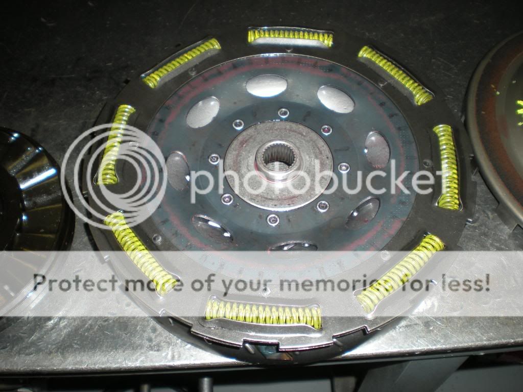

Original CRD Converter Dampener Springs.
Euro CRD Converter Dampener Springs.
My Harbor Freight digital caliper could not get in and measure the wire diameter as well as the dial caliper Ron Wolverton had. He measured 0.080" Spring wire diameter on the Original CRD Dampener Springs and 0.100" on the Euro CRD Dampener springs.

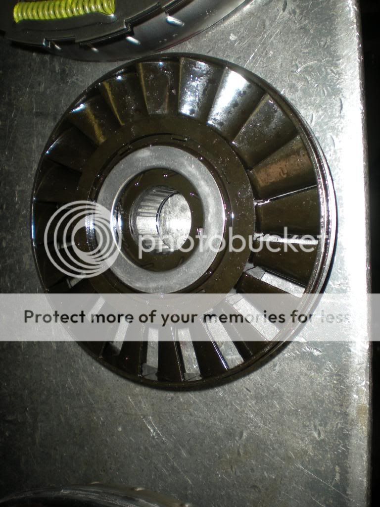

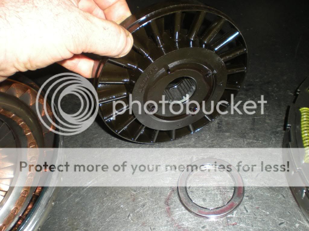

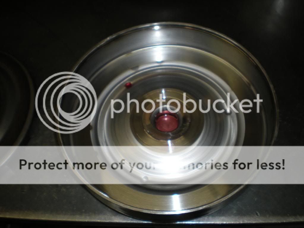

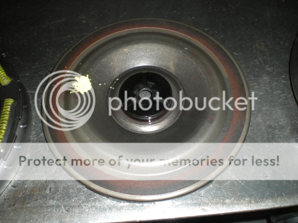

More pics:
Phenolic Stator
Euro
Original

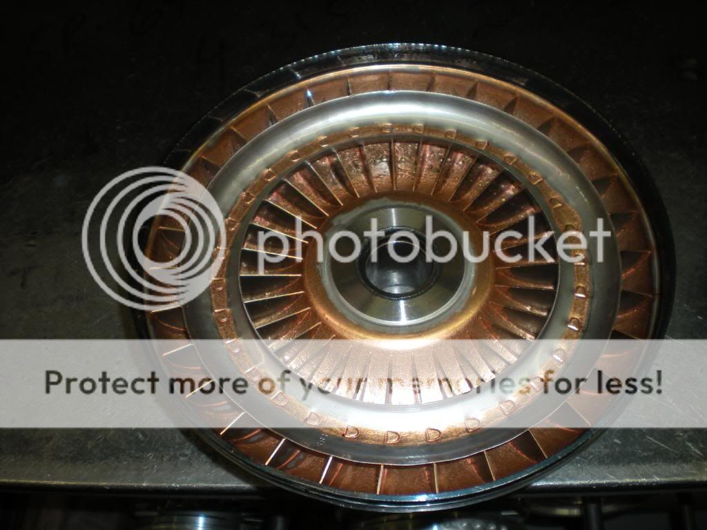

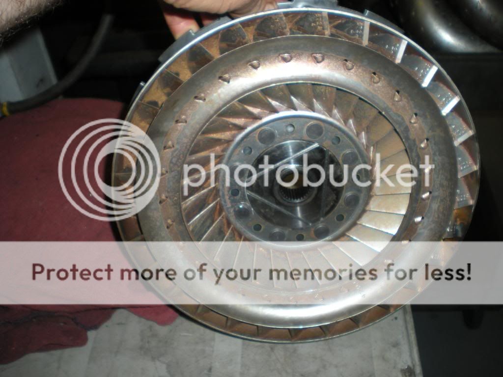

Paper friction material
SunCoast will treat the Euro Converter as a core and reincarnate it into a SunCoast CRD converter.
They will do the same with my core.

When I cut open my old TC there were 2 springs in each location (a smaller one inside the bigger one). Looks like the new Euro one only has one thick spring? Is that correct?

The clutch material also looks significantly different than what my old TC material looked like . . .
The little inside springs look close to the same size on both units.
The only difference any of us could find was the outer dampener springs.
Note: I am not employed by SunCoast and only a customer who bought a CRD converter. Ron Wolverton let into the shop to take a look and photo the Euro Converter.
I am a customer working with them to develop new TCM programming for the CRD. Since I will have my SunCoast CRD Converter installed before the TCM program is ready, I want it to be for my SunCoast converter so my CRD can perform the way myself and other SunCoast Converter owners want it to work. I will not accept detuned performance.

Do you know what material SunCoast replaces the phenolic stator with?
 Post subject: Re: FYI Original Vs Euro Torque Converter
PostPosted: Sat Apr 17, 2010 8:23 am
Posts: 3553
Location: Aurora, IL
Aluminum.

Posts: 5171
Was there any difference on the angle of the stator fins?
Clutch material on both the Original and Euro are both referred to as Paper in the Torque Converter Industry.
Your original was used and the Euro in the photos was only factory dyno tested. Usage of the lock up clutch, background lighting, and camera angle will change the color of the friction material.
SunCoast and many other Performance Converter places use a Raybestos friction material similar to what is used on clutch packs.
I got my SunCoast yesterday via UPS, I did not want to pay or trust Delta to haul it with me.
In a couple weeks when I schedule some time off, I will weigh both my original and the SunCoast so I can figure in the extra Flywheel mass.

As far as I can tell, only the dampener springs are, the rest measures out to be the same.
Larger spring wire, stronger springs.
I suspect the weak dampener springs in the Original set up a harmonic and resulted in the chatter. Chatter like an impact wrench would cause the lock up clutch to slip, generate more heat and resulted in cascade failure.
With the typical Bean Counter oversight, Chrysler opted to stiffen up the dampener springs to cancel out the harmonic so they would not need to beef up the rest of the Torque Converter. That way they can get by with the higher torque of the newer VM 2.8L used out of North America.
Yes there is.
SunCoast basically buys the Sonnax kit at this web site and puts in different parts such as the aluminum stator. Since the Torque Converter is for a Diesel, I suspect they swap out the dampener assembly as well. Also I noticed the impeller housing is larger than the dimensions shown in the Sonnax kit at this link: http://www.sonnax.com/part_finder.php?p ... y_sc=false
The parts are all available for those who have the equipment to trim, weld, and balance when done.
The ART is knowing what to select to make it work the best.
For the bigger rigs like the Ram Trucks, there are more of them out there and more market to justify the engineering. Therefore there are several suppliers putting Heavy Duty Aftermarket Torque Converters together from the basic kits supplied by Sonnax.
