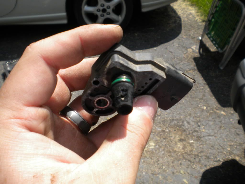

I did the ORM, and the EHM today, along with cleaning my MAP. Holy crap that thing was caked up. I'm excited to see what my MPGs will be now that I have done a few things to it. I got 419 on my last tank, and I'm wanting to break into the 500 club.
Anyhow, here is a pic of my MAP all caked up, I'm glad to have it looking like it should now.

Yup, the ORM and a cleaned MAP will make a difference.
Without the EGR you wont get the soot in the intake, and without the EHM you won't get the oily vapors in the intake for the soot to bind to.
Next I would recommend changing the fuel filter, if you don't know when it was done last then it would be a good idea to change it.
I was having problems with stalling that got progressively worse over 1000 miles while on a road trip, I was thinking air in fuel, turns out it was a badly clogged fuel filter. In my mind I replaced it pretty recently, turns out it had been 50k miles since it was replaced.

Nice work! my MAP was that dirty when I cleaned mine too..... maybe evena bit more caked up. For me I think I started to get 1-2 MPG better around town that I noticed when I calculated by hand and on the EVIC. I throttle responce seemed a bit better too.
