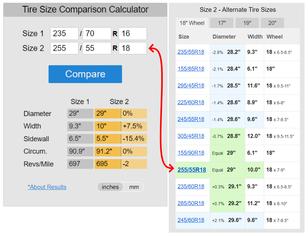

Just so you dont make a mistake when ordering tires.
255-75-18 = 33"
255-55-18 = 29"

Thanks, I’m looking at Michelin Defender 255/55r 18 LTX. Has about 2600lb rating. I bought a new 2003 Dodge 2500 with a Hemi and it came with Michelins load range E. I’ve been a fan ever since. Quiet, fantastic wear and good handling. When it was time to replace found a set off take off Michelin’s and aluminum wheels. Liberty currently has Cooper 225/75r 16. Lasted about 35k. Get 50k to 60k with the Michelin’s on 2500 series truck almost all on the street.
