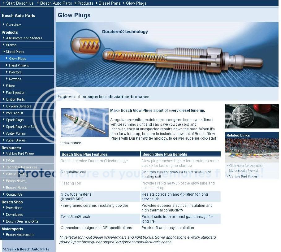

Bosch Part number: 0 250 202 038 and 11 Volts instead of 7 volts
Now being sold in Australia and New Zeland for '02 2.5L - '04 2.8L CRDs, but not here, WTF :banghead: :banghead: :banghead:
Update: We have the Rapitherm Glow plugs a newer generation that are to help emissions. From what I found out TDI/PD owners are switching back to the Dureterm to reduce damaging engines.
The beginning of the Dureterm catalog gives a warning about over advanced injection timing can be a cause of short life of glow plugs. Some tunes have a little more advance to get more fuel economy than others and the little extra advance may be why some are having more problems. When I over advanced timing on older IDI VW diesels to get more fuel economy, I trashed glow plugs faster, but since I bought them cheap by the box and they did not damage the engine, I did not care back then. Later I figured out how to curve the VE pump to the engine and got more performance with out trashing glow plugs. On my CRD with a ceramic glow plug that can destroy an engine, trashing a glow plug for a little more MPG is not worth the risk for me. :2cents:
Catalog: http://www.bosch.com.au/content/languag ... _Ready.pdf
