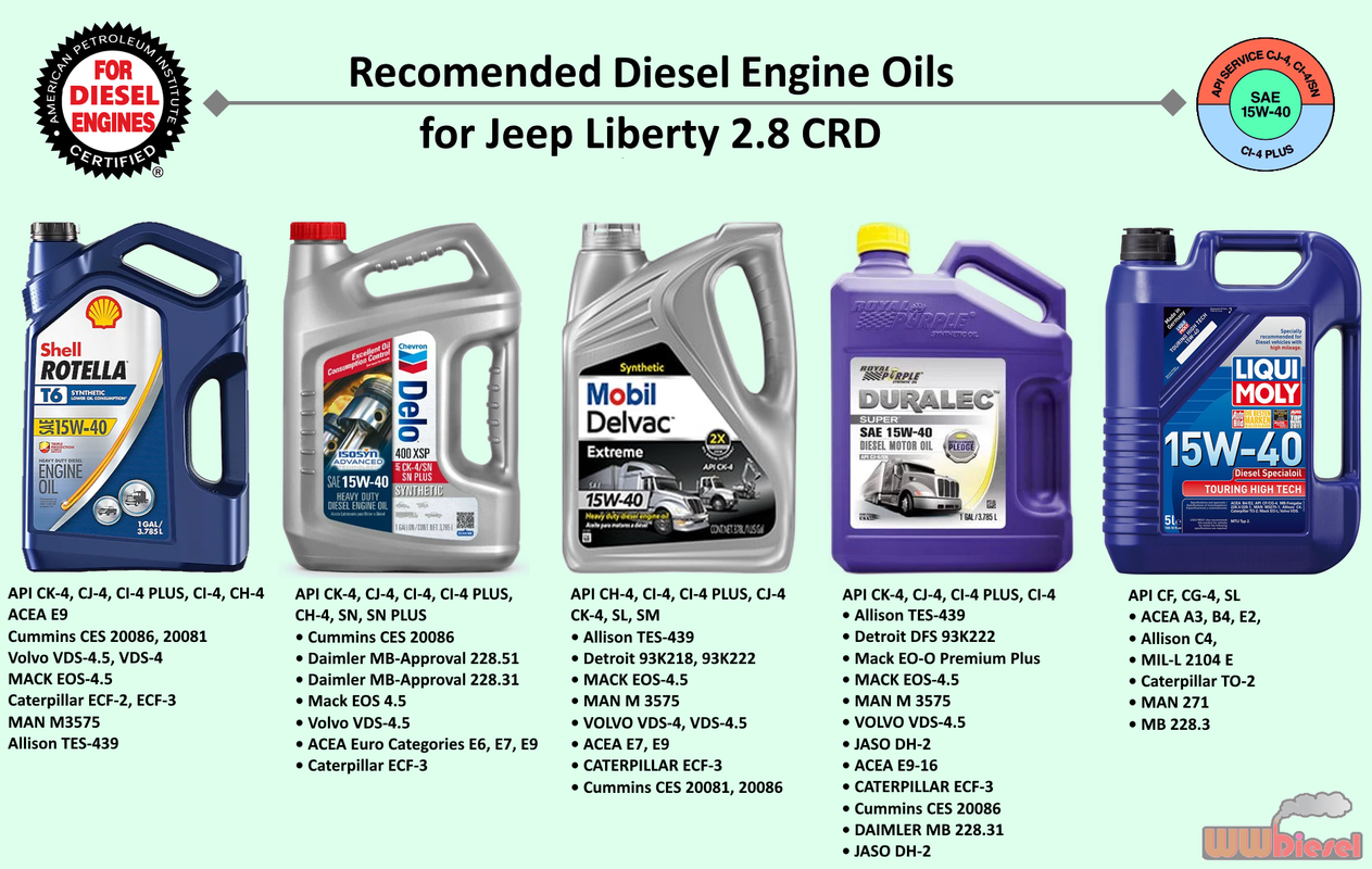

A big problem with the oil tests link you shared; there is NO comparison of API "Diesel Rated" oils that I could find, all their tests are on oils for gasoline engines.
If you are using 15W-40 full synthetic oil in your CRD, be darn sure it is a API Diesel Rated oil, CH4 or higher; preferably CK4 is best.
Using a Gasoline rated oil in a diesel engine is a recipe for disaster! :grim:
Note: I run Shell Rotella T6 Full Synthetic 15W-40 oil year round in my CRD and have never had to add any oil between oil changes performed every 5k miles.
Some of the better oil recommendations for your Diesel engine:
