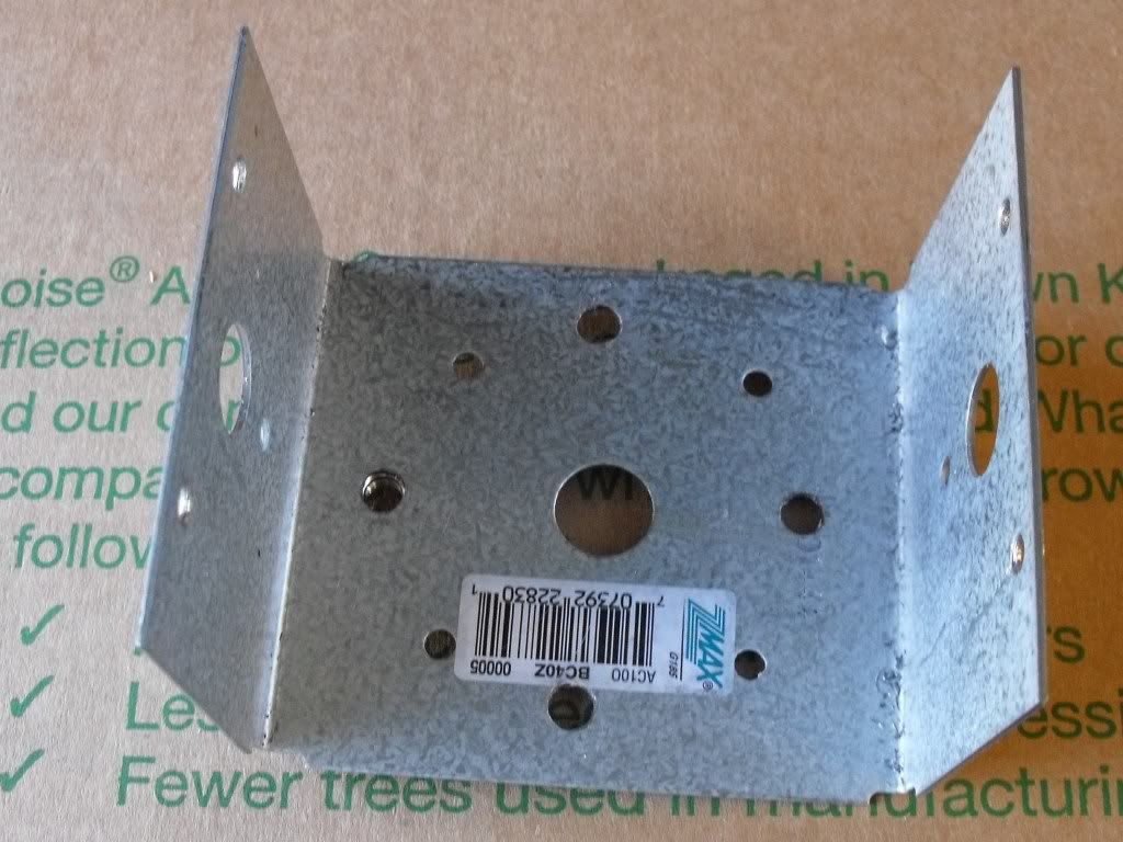

Thanks for all the info. I have everything I need except the wellnuts and they are on order. Went to lowes looking for something to make a mount from and came up with the metal connector used on the end of a 4x4 post. Made of galvanized steel and just the right size to hold the Facet pump. Even better is you can use a second one to make a cover to protect the pump from rocks. I put the two together with some self tapping screws. I will try and get some pics uploaded as soon as I get the pump mounted. :BANANA:

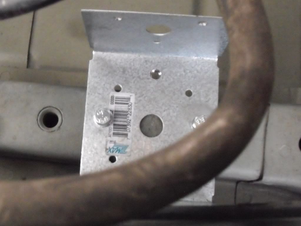

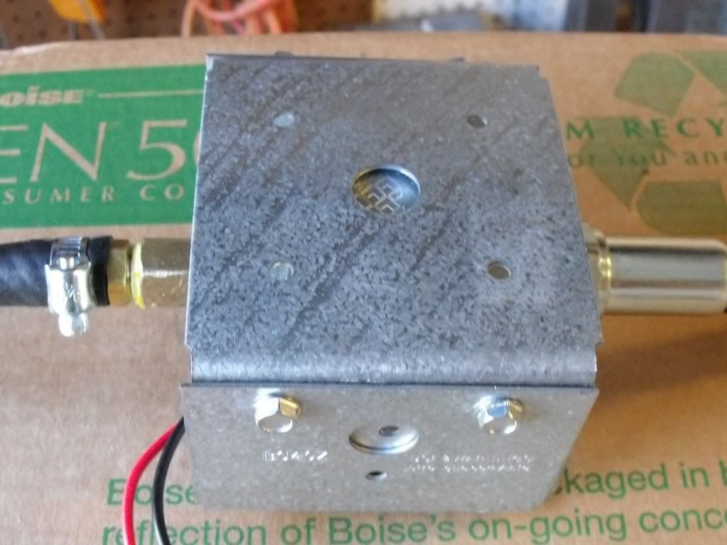

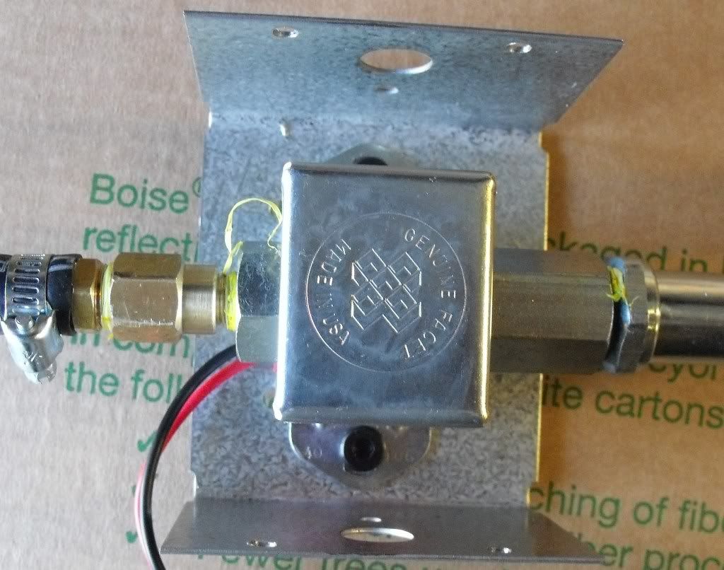

Some pics of what I have done to date. Family visiting this weekend so couldn't finish the plumbing today.
4x4 post bracket from Lowes. Drilled at top and bottom for the bolts to mount to the cross member in front of the fuel tank and at each side for pump mounting bolts.
FACET pump mounted to 4x4 post bracket.
Second 4x4 bracket mounted over the pump with self tapping screws.
Bracket mounted to cross member on drivers side.
