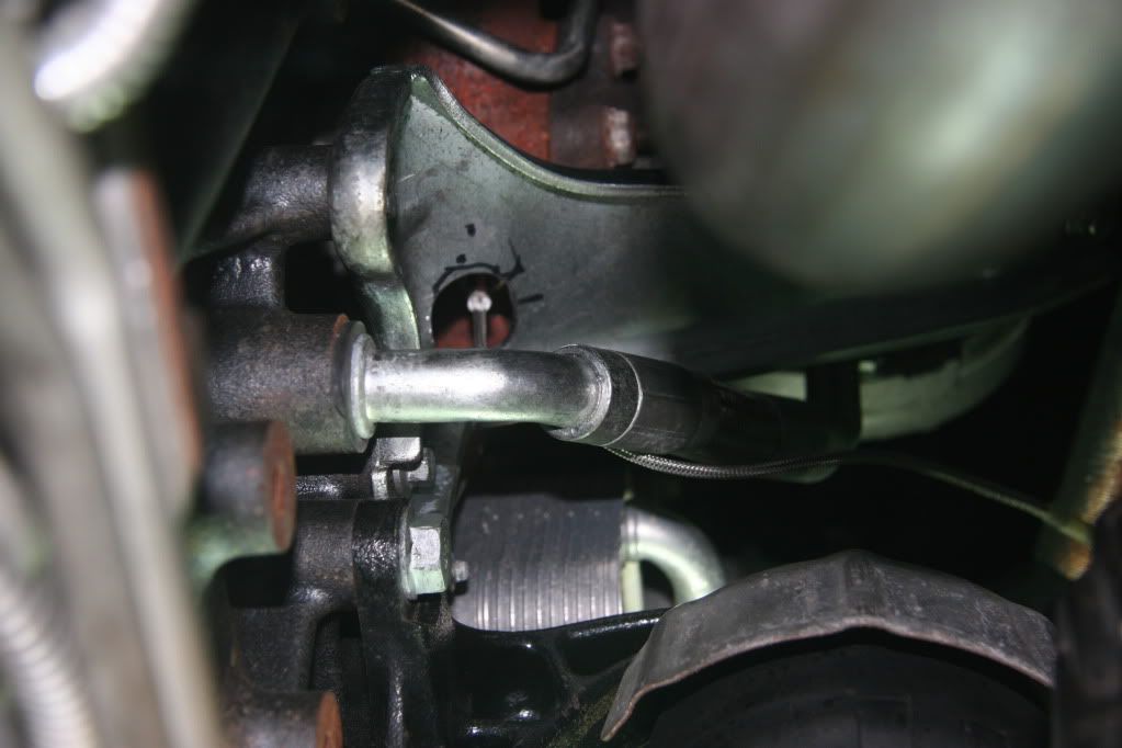

EGT

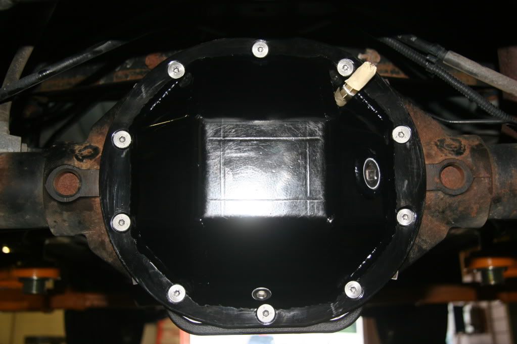

Rear Differential Temp

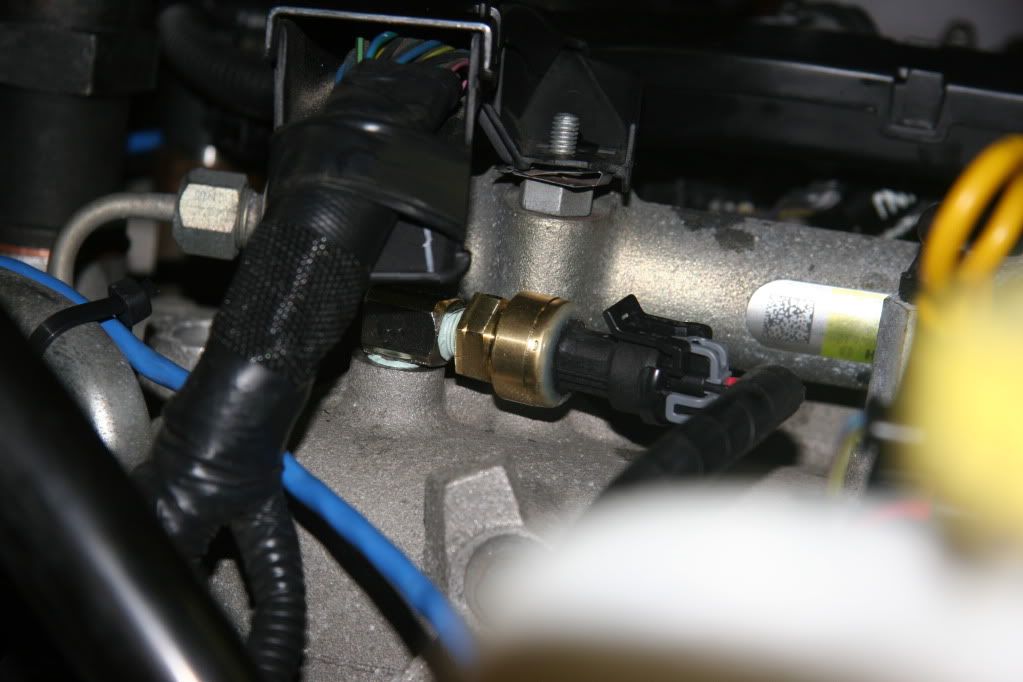

Turbo Boost in Intake Manifold

(although did you have to pull the turbo to do the EGT - or can you get to that from the bottom?)

You can get to it from the bottom.
Just remove 3 bolts to remove the bracket.
Drill and tap manifold.
Cut out hole in bracket.
Install pyro.
Remount bracket with pyro lead comming out through hole.
Tip: You are going to need a really long drill bit extension (about 2').
