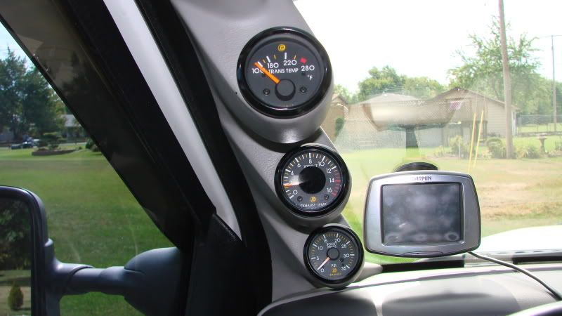

Id love to add those pillar gauges but I use the grab bar getting into my vehicle.........HJ
