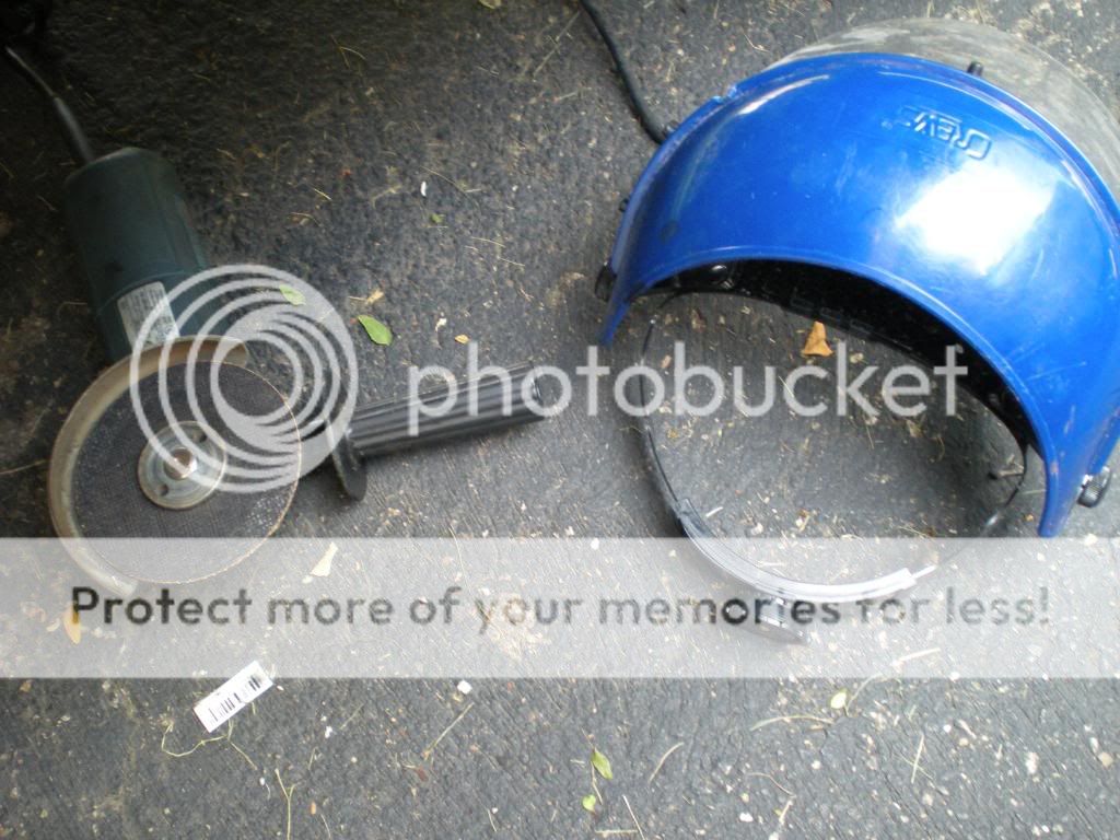

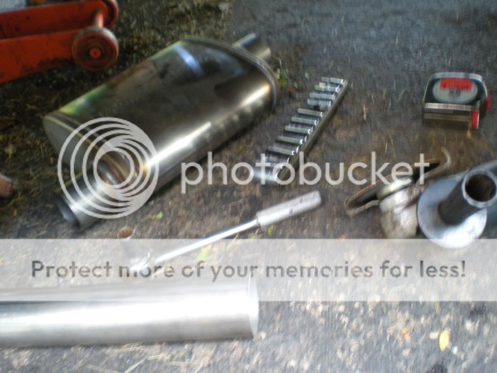

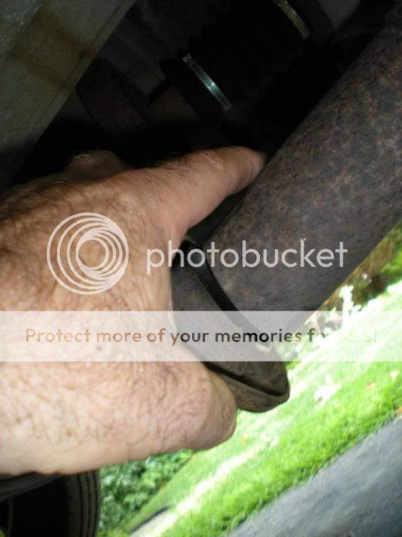

After I got some other work done today, I got out my Magnaflow and did the installation. Some tools and supplies rounded up.

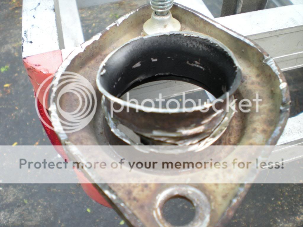

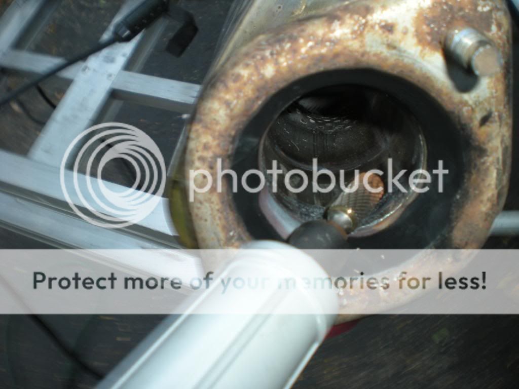

The first thing I noticed after unbolting the Stock Muffler was the 2 3/16" choke down restriction on the Cat flange.

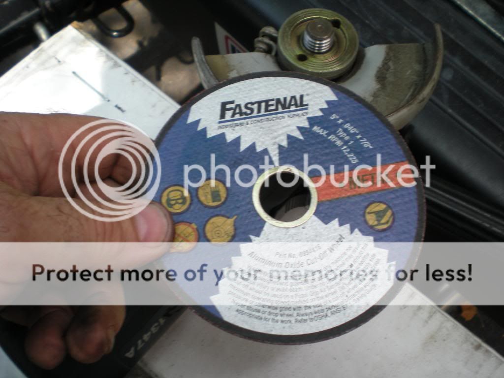

First thing was to cut off the Cat Flange.

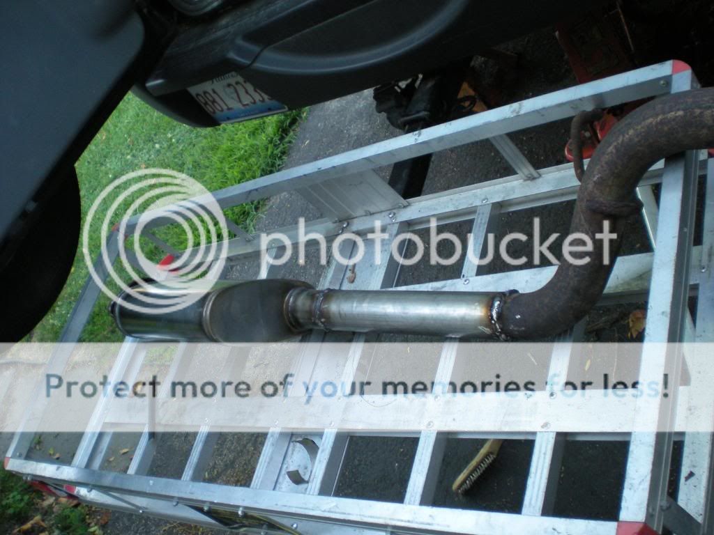

Then I cut a short piece of stainless steel 2 1/2" 303 pipe and got it into position to weld. I used the Stock Muffler to hold the flange in place to tack weld in place.

Muffler flange welded to Magnaflow.
Burrs removed

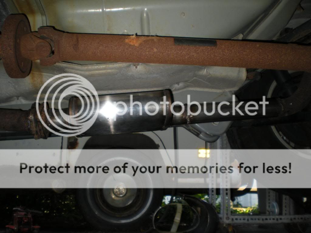

Pipe was tack welded to 2 1/2" SS Pipe and welded tight. I used a small floor jack to position the pipe on the Magnaflow and Tail Pipe.
Installed on CRD.
I had one leak on top of the Cat flange where I missed welding a 1/2" section. I got out the mirror and blind welded the 1/2" section I missed. Where the Cat flange mated up to the short section of pipe I had to weld on the inside and clean out the excess weld with a die grinder.

The flange on the back of the Cat is necked down to 2 3/16" ID and needs to be opened up to 2 1/2". Lots of ways to do it right, I picked an option that worked with what I had on hand.
On the level full acceleration with no trailer the gauge piped in between the Turbo and the Cat stays at 0 PSI. When I climbed a 5% grade entrance ramp I got the back pressure to climb to 1 PSI. With the stock muffler it would have climbed to 4.5 PSI under the same load going up the 5% grade. The boost gauge jumps up to 15 PSI to 18 PSI on flat land acceleration.

One of the biggest restrictions in the Cat after it is purged out is the bottle neck at the flange where the muffler attaches. Replacing the flange or cutting out the bottle neck and replacing it with larger pipe as I did, removes the Cat's biggest restriction. Bolting on a 2 1/2" Cat back with out getting rid of the Cat flange bottle neck will not produce optimum results.
