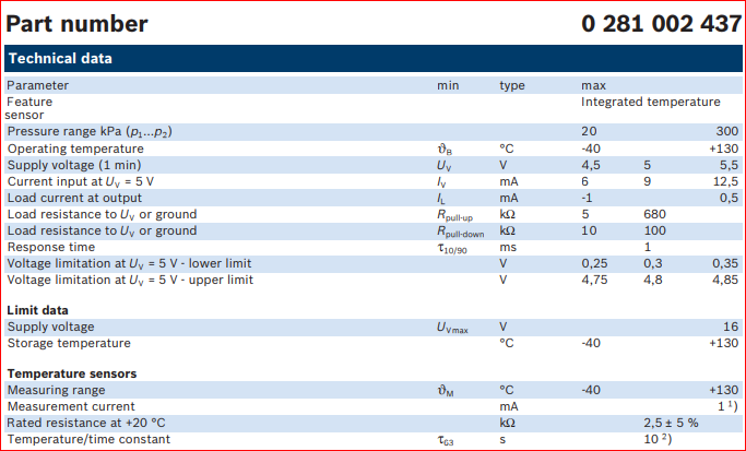

Anybody know the normal operating spec for MAP kPa @ idle vs WOT @ low altitude?
Re boost response/reading, a bit of a change during road-trip. Before, when COLD the turbo response was strong and even, giving a WOT MAP of >25kPa @ about 25# of boost.
However, on this road-trip it seemed like the cold-response wasn't as brisk, though I didn't monitor w/OBD. Add that after warmed-up if I asked for too much throttle too quickly it would stall [4 times], a misbehavior it wasn't displaying pre-trip. Before, instead of stalling it would just refuse power.
Actually, that is part of the symptoms that has me reconsidering my prior opinion that this power issue is strictly related to electric-control systems, not fuel supply.
These symptoms remind me of a lifetime dealing with fuel issues: from Accords with dirt in the tank to IDI Fords struggling to drink from bad/thick/airy WVO, as well as a myriad of failed pumps/lines/fittings/clamps...
Along with its sputtery-song, that stalling now has me nearly convinced to work tank-forward confirming fuel quality/volume/pressure. @#%& ! I WISH i had installed the in-tank pump instead of an in-line Kennedy :banghead: :banghead: :banghead:

My66dodge wrote:
I will grab the normal MAF readings when I get back to work monday, they are written down in my toolbox
He said MAP, not MAF.
Does this help any?

I was thinking he was looking for MAF v @ idle and wide open on a healthy engine
