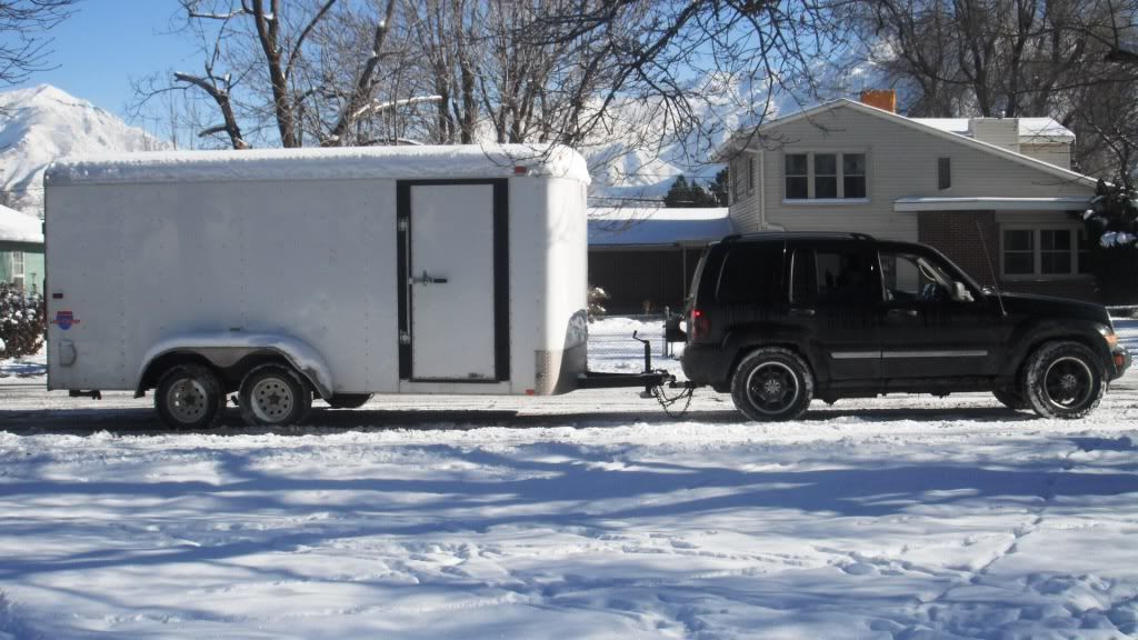

I've been more than happy with this little Jeeps ability to tow so far. I haven't done any long trips yet, but I have had this rig up to freeway speeds and it feels nice and stable both accelerating and decelerating. Still need to get a Prodigy before I hit any big passes.

Not bad Roostre, is that a 7x16 Haulmark?
I'm the crazy towing fool around these parts, right now I'm driving around Savannah, Ga yanking a 75kw Cat Diesel generator to film set locations. 6900 lbs is the trailer's GVWR, and I know from a previous experience that this setup is just about 6800 when fully fueled. Add to that, probably close to 750 lbs of FEEDER cables (100 foot of 4/0 gauge cable, times 5 conductors = 500 ft of cables) and this is a BIG load to be hauling anywhere.
The CRD has been handling it just fine. Drinking the diesel, certainly, but not a big problem on the haulage. I also have pulled a 7.5x20 enclosed box like the one you picture, only bigger. That scaled at just about 2000 empty, and 7000 fully loaded, with a scary 1200 lbs tongue. I've loaded and re-loaded that trailer with the heaviest things way behind the axle, and still thats where it ends up. Bad design, but I don't move it that often so I don't care. Here's an old picture of the 70kw generator that I scaled to know it was 6840 fueled... This genset is just about the same unit.

Close. 7x16 Interstate. Not much difference.
