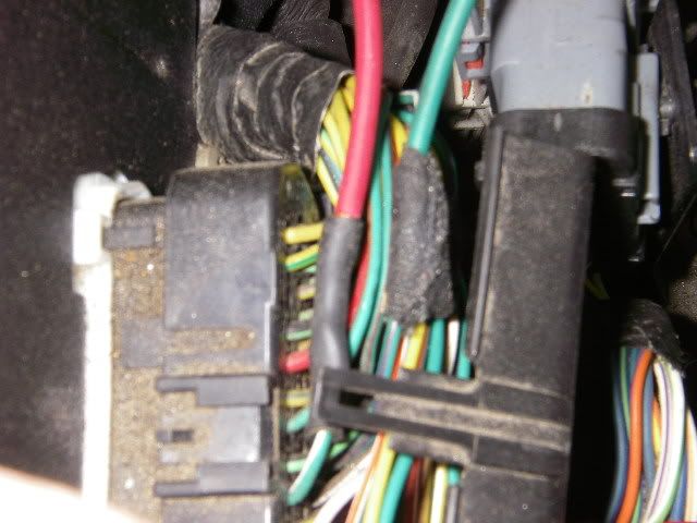

I have found that there has been some sort of electrical mod put on the trans. I'm guessing that it could be to turn the fan on if the trans temp goes up, but I'm not sure about that. Anyone able to shed some light on that with the pictures below?
On the transmission
Up at the TCM - covered pulled back to show where connected

Looking at those wires it almost looks like someone ran them to replace a damaged circuit leading to whatever that is on the transmission.
This seems like a good possibility to me too.
My CRD had some non factory wiring going from the cam shaft position sensor to the PCM... turned out to be just a repair. I would look at the wiring diagrams to figure out what pins on the TCM they are going to.

CATCRD, I had thought about doing a turbo timer. Any tips on installation? The last one I put in was on a turbo MR2 and you could buy a specific harness. I doubt there is such a thing for the Jeep.
I'll dig into the service manual and see if I can find pin outs.

That is a factory sensor on the transmission it controls the shift firmness. When you install a shift kit it comes with a resistor that is suppose to hook the two wires together but it shifts to hard in the libertys so most remove them after trying them of course.

I still want to check into the TCM pinouts, but I bet you guys are correct in that it is a repair.
