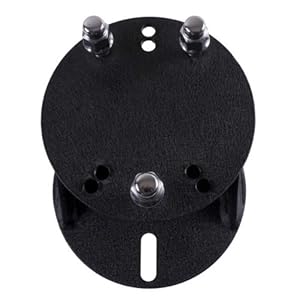

I want to use this
Imagehttp://www.amazon.com/Rugged-Ridge-11585-02-Textured-1976-2010/dp/B002CM75M0/ref=au_pf_pfg_s?ie=UTF8&Model=Liberty%7C353&n=15684181&s=automotive&Make=Jeep%7C42&Year=2005%7C2005&newCar=1&carId=004

They do make a spare tire mounted bike rack. Mine only holds two bikes...

The classic method of getting more hitch clearance is to take the spare off; undo the 4 nuts holding the spare tire holder on; rotate that holder 180 degrees; and reinstall holder and tire. That moves the bottom of the tire up and in toward the bumper while still leaving clearance for the window. I don't know that it would give enough clearance for the hitch you illustrate. I'd also be concerned about turning clearnance for a trailer (not knowing what you tow) with 4 bicycles mounted over the tongue. Wouldn't it be better if you are towing to mount the bike rack on the towed item?

2.) I'll look at flipping the mount around. I had not thought of that. I have taken the spare off before to tow certain things but I prefer to leave it on for obvious reason.
3.) I looked at the spare tire bike mounts. However there are 4 of us and the spare tire mount seem to only go up to three.
