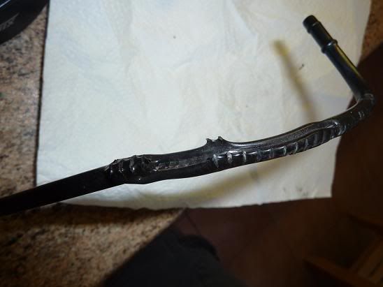

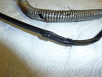

found it !!!! :BANANA:
I had checked only the vacuum hose from the solenoid to the EGR.
I removed the one from the solenoid to the back panel (slightly larger diameter) yesterday night, i could barely remove the braded protector from the tube, both were welded together from the heat....
The tube was totally destroyed of course...
hope you can see from the piccs....
I ordered a new set from the US : 58$ plus USPS....
Also, i want to rebuilt a set myself out of metal pipe, i cant be convinced that plastic pipes are doing fine in the hot environment of an engine bay...... Someone has done it before ?
Thanks to all of you !!! Again this forum has amazing members and resource !!

Erratum, you are right the line that was not damaged was going from the solenoid the turbo, or to a valve on top of the turbo (not to the EGR). That line is fine .
The one which melt down (pics above) and collapsed on itself under vacuum, is going from the solenoid to a T junction at the back panel, it goes behind the cooling fluid tank (2 bolds from the tank needs to be remove to lift the tank up, to unplug the line safely). There, it is connected to a T junction: one line goes into the dashboard (hole on the passenger side. Any idea what a vacuum line is going there for ?.... :juggle: ), the other line is crossing the whole engine bay towards the passenger side and to what i think is the break system, correct ? (guessing only...).
When i unpluged the damaged portion of the line, i heard a long whistle from the line that is going to the driver side.
As you see on the pics the line has melt down and collapsed on itself, the side going to the breaks sealed itself when it melted so the vacuum got trapped. that explains that i did not experience sluggish breaks i guess, no?
The side going to the solenoid is open to the outside= hole, so that gave me the lack of power and the P0299.
I will take pics of the exact location of that demaged line tonight and post them.

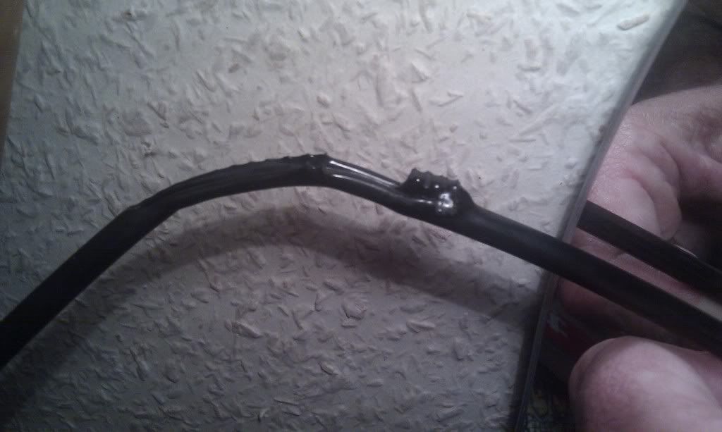

Well that is surprising, I'll have to check mine and make some protective modifications.
Was the plastic vaccum line touching the hot coolant tank?
 Post subject: Re: OBD P0299...replacing parts and still on....HELP...
PostPosted: Tue Jul 12, 2011 10:23 am
Posts: 457
i will never manage to write it corretly :jester: : the line was in deed going from the Solenoid to the turbo valve ( i typed "or" in my description above) but am sure you got it... :SOMBRERO:
yes the line that was damaged was touching a metal piece part of the coolant tank. But that portion was protected by the braded tube. Result , the protective tube and the line were welded together. On the pics you may be able to see some stripes on the line, these are actually where the protector was welded to the line. I had to use a knife to open the protector and separate it from the line...Again, i will take some more precise pics of the location and post them.

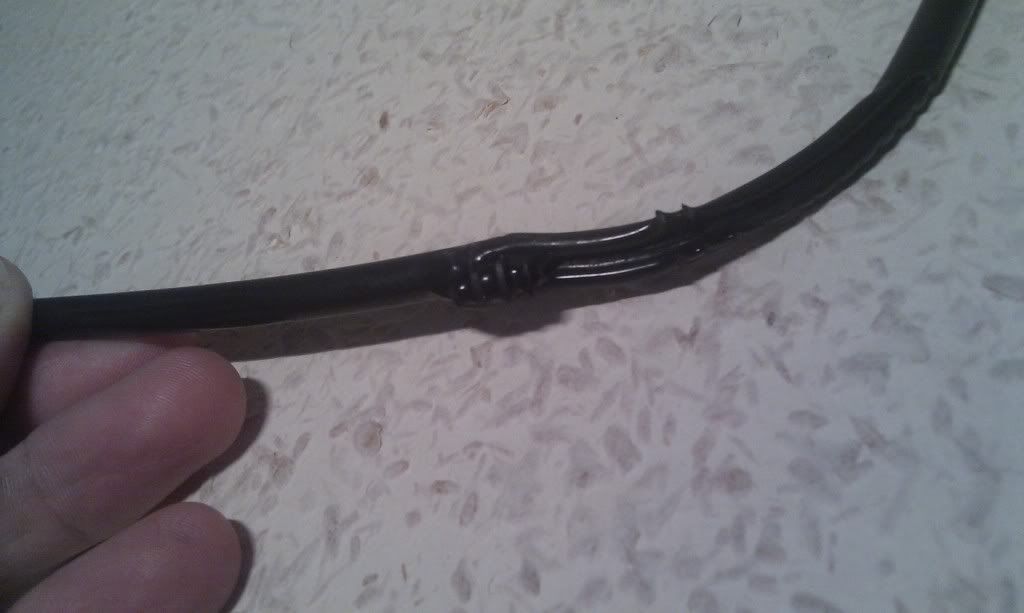

here are some aditional pics of the Line. it is the one with slighly larger diameter, which is connected to the solenoid by downward U flexible tube.
the point were it is melted is indicated by the knife:on that pic the 2 lines from the solenoid are still taped together, the protectors are removed. the one damaged is the larger and shorter line with the downward U at one end.
and some closer look at the damage:
and here is an attempt to show the exact location of where the line was passing and where it was broken. on this pics the coolant tank is unhooked and slightly lifted up: (please totate the pic 90 degre clockwise, could not do it in Photobucket... :SOMBRERO: )
ok, let me know if this is clear, or if you need more info. And GOOD LUCK in getting your KJ back to normal !!
