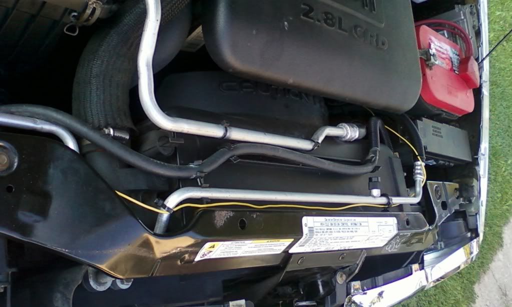

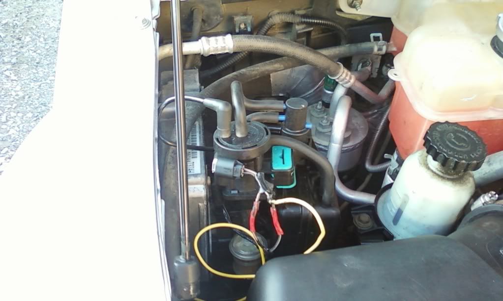

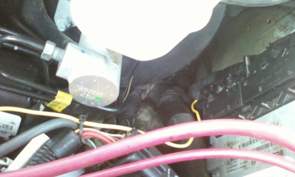

Here are some pics of the mystery jumper wire. It is connected to a Brown wire with a white tracer..................

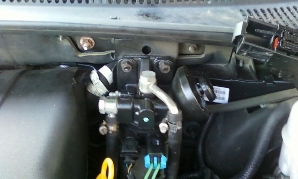

Also can anyone tell me if this is the good filter head.........................

You have the new fuel filter head. The wiring fix is for the turbo electric vacuum module, this controls the position of the vanes on the turbo. The replaced wire is the signal line from the ECM that regulates the PWM (pulse width modulated) duty cycle.

What kind of dealer runs a wire like that?

I can see replacing a bad wire by running a new one but when that's done the old wire is either removed or left disconnected. If I am not mistaken it looks like the old wire remains connected at both ends which seems odd, never mind the quality of the installation.
