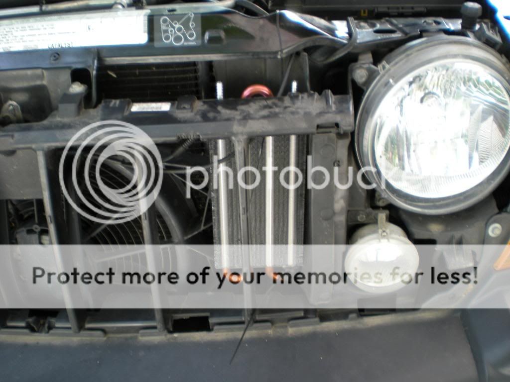

Hayden Severe Duty fan clutch, 11 blade V6 Plastic Fan, fuel cooler on return line, no more problems.
OH, remove the Fuel heater relay in the power center.
Having a fuel heater when it is warmer than -10F is as stupid as having heated seats turned on when it is 100F+ and the AC turned off :!:

Warp
Where did you mount your fuel cooler?

flash7210 wrote:
Warp
I keep the fuel heater fuse pulled year round.
I will be doing an upgrade when we get the damage to the house we rent out repaired and get it rented. They did not detonate a bomb in the house, but after they moved, they got into the news: http://www.oaoa.com/articles/year-69161-old-son.html
Anyway, I am going to bolt a smaller plate type trans cooler to a larger plate type trans cooler and put them in the same location as the fuel cooler. When I get it done,I will post the pics. Why am I going to replace the existing fuel cooler? It is in the way of where I want to put the large trans cooler and the small cooler will fit on the top. Simple solution, simple is best.

Warp,
How did you route the fuel lines for the fuel cooler?
