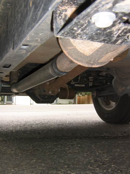

I finally found time to put the 3" exhaust on. It looks nicer than the side exit exhaust. I haven't noticed any loss of power and the sound in the cab is quieter.
http://liberty.eurekaboy.com/tailpipe.htm
