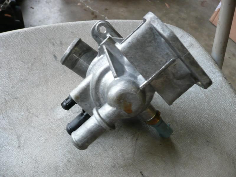

when I bought my CRD, I negotiated a 'full tow package' for free into the deal; wiring kit, hitch, and upgraded cooling package, all MOPAR. When I got the Jeep home, I started instilling the bits, and found the upgraded cooling package is for the V6 gasser, as every CRD has the parts already installed at the factory. I put the kit back in the box, and stuffed it away in the garage for a rainy day/spare parts.
Because the CRD and V6 upgraded cooling package are the same parts, does this mean the ligher-weight nylon cooling fan from a standard V6 is reverse compatible with the CRD? I plan on removing my mechanical fan from the CRD when my XJ is back up after an injector swap/relearn, but would there be an advantage with running the V6 fan in the summer? Less rotating mass and all that?
The other addition to this subject I have is this...
I just removed the XJ's mechanical fan setup, including bracket, and installed brackets from a ZJ and 2.5L XJ which allows me to bypass the AC compressor. I then installed a 13" electric cooling fan from a 3.0 Ford Taurus into the mechanical fan shroud on the XJ. The fan setup is fully autonomous, being activated by a thermostatic switch from an older BMW, on at about 203F and back off at 194F. Now that winter is setting in here in MN, I only kick the primary e-fan on while idling around parking garages, and my secondary (factory condenser fan) has yet to engage, meaning temps have not reached 220F yet. This may be an option for those who need that primary fan for summer use, but don't want to spend the summer turning that heavy mechanical fan assembly.
Looking at the thermostat assembly, there is a flat area on the bottom that could easily be drilled/tapped for the installation of the BMW switch. Would this location be in the "hot" area before thermostat opening?
There is also another BMW switch that has a low (196F) and high (210F) setting, which could be used in conjunction with a two speed fan setup.
Thoughts?
-Rich
Yes. But when the 'stat is at full temperature, that area (small round circle) has no (minimal) coolant flow.
But this probably doesn't matter.
