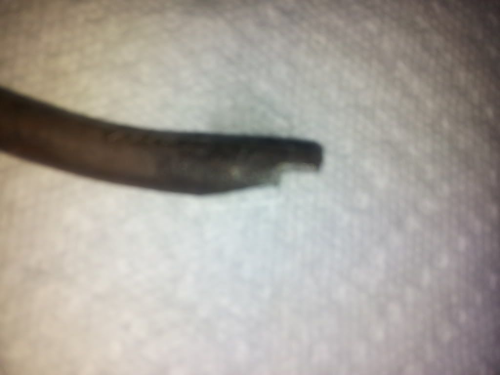

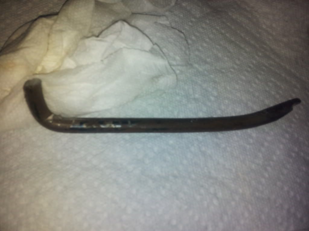

I used the hammer and wrench technique on three different occasions with no positive results. After studying the fan pulley I tried some screw drivers and other pries to try and lock the pulley while I wrenched it off, also to no avail. This work did spark and idea to make a tool that would lock the pulley against the engine lift bracket mounted at the front of my engine. If I could make one it should REALLY simplify this process.
I found a piece of steel rod that is an orphaned under car spare tire handle extension. It is 5/16 to 3/8 in diameter. Using a grinder I shaped a tip that would easily go into the holes on the fan pulley. Using a vice I put a 90 degree bend about 7 inches from the tip (looks like 8 inches would work even better), then using a hack saw I cut the end off so the bend had about a one inch tail.
Using a vice and hammer I put a bend in the rod so it would lay flat against the bracket when it was in the pulley hole.
Using the tool I locked the bracket in place by turning the pulley with a wrench then with just a bit of pressure broke the fan nut free. Now with the tool I can break my fan loose in 1 - 2 minutes. Time to make the tool was about 30 minutes, with an extra minute needed to break the fan nut loose.

I used a 16" pipe wrench to pull the fan. It was just narrow enough to fit on the fan nut soI had to bend the tool so that I maximized clearance or It would have been off to the store for a box end wrench that would fit. Wish I had thought about using the impact wrench, I got one of those. I am sure my fan was never off since the factory put it on, but it really took very little force to loosen it, I bet the impact hammer on the handle of that pipe wrench would have worked just fine. Oh, well, since I will be putting a fixed fan on each spring and taking it off each fall, the tool will be put to good use.
I am cheap, my tool is free to me, only took 30 minutes to build, and will work every time I use it so I am pleased with my result.
