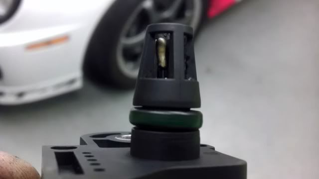

As an update, I finally got around to spending an evening tinkering. The results = 8)
I started off by inspecting both the FMIC hoses. I suspected they were fine but removed them and looked them over anyways. They were. The FCV was all oily, but open. On the note of the FCV I always felt like the engine shut off a "bit rough" based on everything I read about the FCV and its function. I was never worried, I just assumed the FCV wasn't doing its job. More on that later.
I noticed where the end tank of the FMIC meets the core on the hot side was a bit oily. Makes me wonder if there is a leak there. :roll:
Some day, after I do an EHM of a sort and feel like cleaning everything out I will inspect, until then it is what it is.

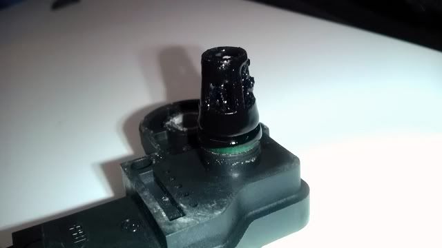

I ended up pulling the MAP.
Cleaned it up, took all of 2 mins.

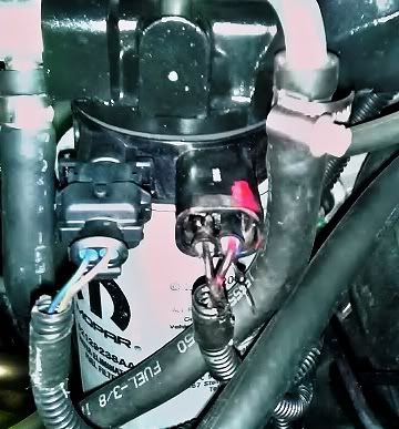

Also bled the fuel filter. Had no reason to believe it needed it, but figured I was playing around I'd spend the time. I also noticed one of the plugs was "modified" at some point by a previous owner/mechanic. :| Is this the connector that tends to "overheat"? I wonder if this was fuel head was replaced at some point?
