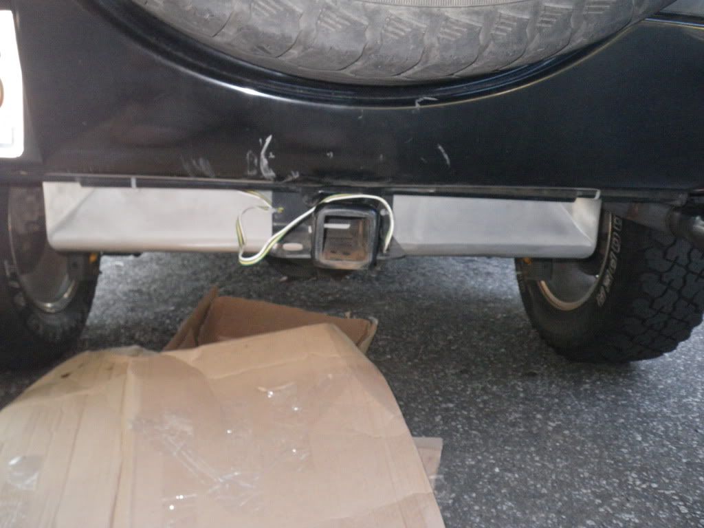

I dropped the tank on ours when installing the lift pump from a Dodge pickup (w/Cummins)...
Loosen the bolts holding the straps, down it comes. Don't forget the filler tube - I think it uses a wire type hose clamp.
The fuel fittings are easy to pop off if you familiarize yourself with the fitting first... Good pics of the fittings (etc) can be found here: http://www.auerbach.ca/kj/lift_pump/
Disconnect the electrical connector (fuel gauge), and you're good to go. Should take you a half-hour to pull it - you may need good penetrating oil for the bolts on the tank straps.
Naturally, you'll want the tank as low on fuel as you dare. In my case I used an old fuel pump and sucked it out at the fuel filter fitting in the engine compartment. If you're going through that much trouble, I'd order the in-tank pump and wiring harness from a gasser (check the lift-pump threads for details) and get the whole thing done in one swell foop. :lol: :rockon:
