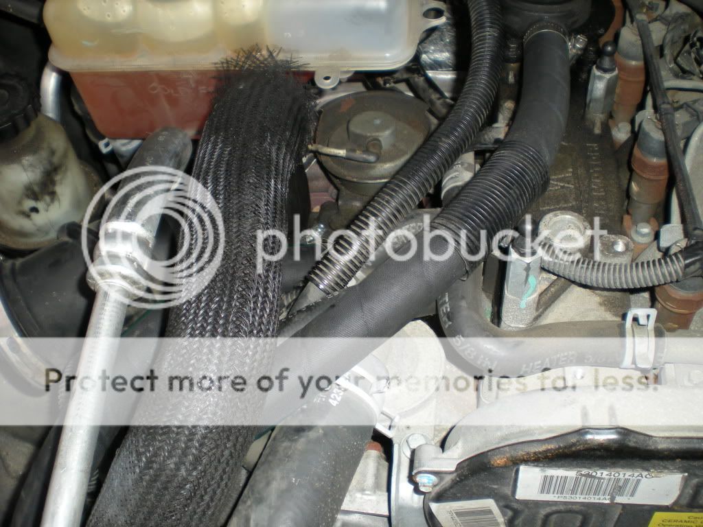

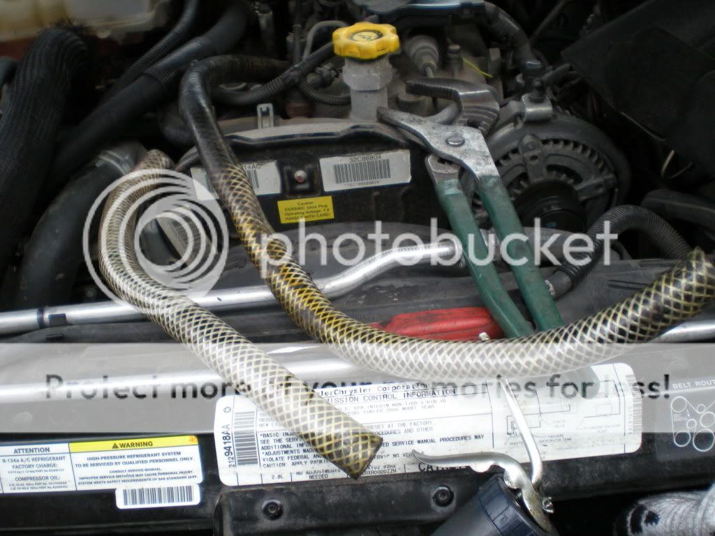

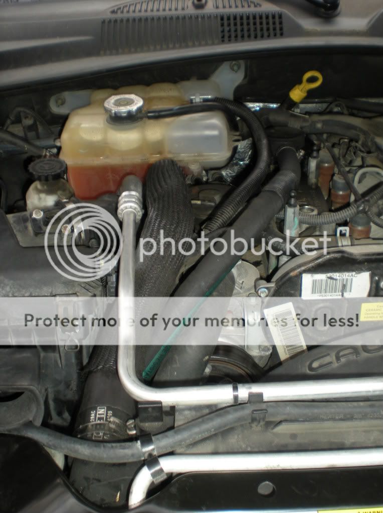

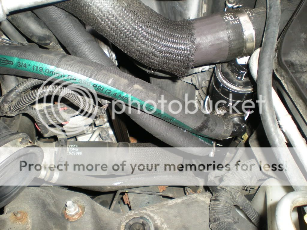

Here is where I installed mine patterned after the TDI Guy's unit.
I used 3/4" hydraulic return line hose, the 3/4" braided clear hose got hard and had to be replaced. I installed a 3/8" drain line that returns the oil to the sump.
Plastic barbed elbows did not work and were replaced with steel elbows.
