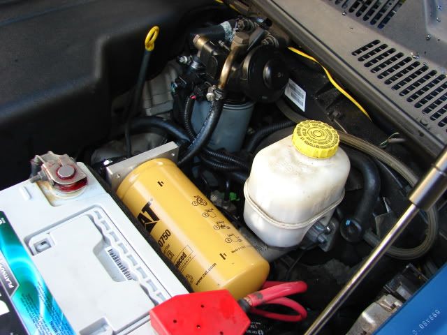

Over 5 years ago I added a intank lift pump solving my air in the fuel problems :seuss: And no the air leak was not from the original fuel head I still have :juggle:
Recently at 49K miles I started seeing horror stories here on 100k mile CRD's with fuel system problems so I added a 2 micron CAT2 filter between the stock fuel head and the CP3 HPFP :BANANA:
That way I have all the functionally of the original head and the stock 10 micron filter acts as primary filter before the Cat2 :mrgreen:
The line between the CP3 and OEM fuel head is connected to the output if the CAT2 filter and a short piece of 5/16" (7mm) fuel hose connects the output from the OEM head to the input of the CAT2.
The problem was finding a place to mount a second filter :dizzy:
My 1978 VW Rabbit had a 10 micron filter and I wanted better filtration for my common rail system :JEEPIN:
A lot has changed since 1978 :ALONE:
When the CAT2 adapter was available members here had not yet learned of the benefits of a adding a lift pump and the added restriction of the Cat2 compounded air entering into the vacuum system :5SHOTS:

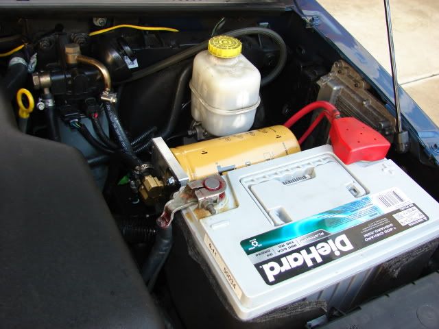

That's the filter used but I made my own mount and adapter. The mount uses the bolt for the battery hold down and I used a aluminum plate that I machined to screw the filter onto and used brass fittings on the top. That makes it easialy removable for trips to the dealer for extended warranty :SOMBRERO:
I couldn't find a mount locally for the cat filter thread size so I made my own. Here's some pictures but little detail. I was assured mounting the filter horizontal would be fine.

Wouldn't it be easier to mount a 2 micron racor filter where the stock goes?
 Post subject: Re: Dual filter question
PostPosted: Sun May 27, 2012 7:55 pm
Posts: 3442
Location: Columbus, Ohio. USA
Probably but I have another year on my 7/70 extended warranty and this one comes off with with one bolt and two hose clamps and leaves no trace :SOMBRERO:
