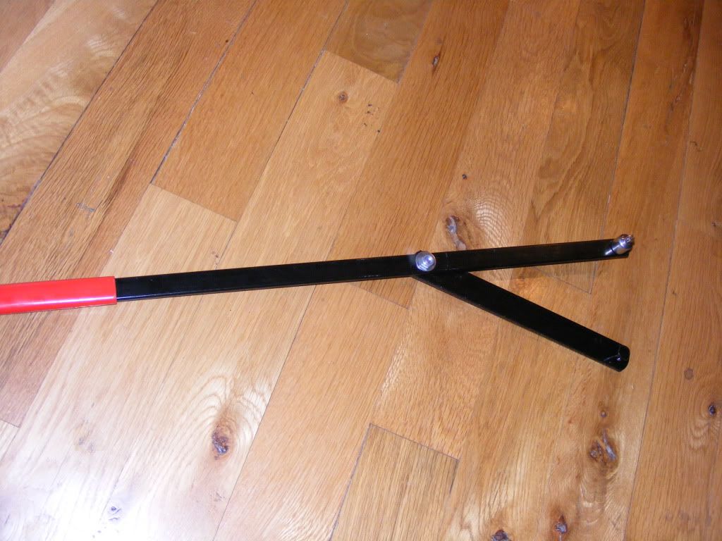

It's cool setup bambi is under 4k beefy little trailer. Pulled 80mph going uphill lol during night time flying past big rigs like there parked. During hot day I would never do such thing build to much heat. I stopped the clutch replacement not having tool to hold thing from turning. Still have parts now I have noticed tensioner is bouncing around just another item to replace. I put aftermarket belt on with less suppleness maybe that is the issue?
Your tool gave me an idea this tool is thin walled for tensioner adj, I drilled hole and wolla If I can find 3/8's to 1/4 I am in game.

The holes in the pulley are bigger then 1/4", Before changing your 3/8" bolts try them. But I suspect that they are a 8mm that is close to 5/16"
