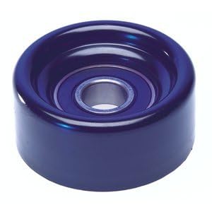

I don't know but if the OEM pulleys are like the NAPA 36101 substitute the pulley is steel so it shouldn't be a big deal, with the right press, to press out the old bearing and press in a new one alhtough it looks to me like a bit of support on the "back" side of the bearing might be in order.
That said I don't know bearing size or whether it would be cost effective. The NAPA pulley is all of $20 but the bearing is Chinese which may or may not be an issue.

Yes, the bearing is a standard 6203. mark the position so you can assemble the same way, drill out the three rivets on a drill press , split the two halves of the housing and pop in your new bearing. I used three high quality machine screws in place of the rivets with a drop of Loc-tite. Also check the two reverse thread bolts that hold the idlers on. One of mine was stretched out so I replaced both for good measure. total cost about $30.00 for all three including the bolts. Considering the stress and heat these bearings are under, I would avoid cheap off-shore bearings.
