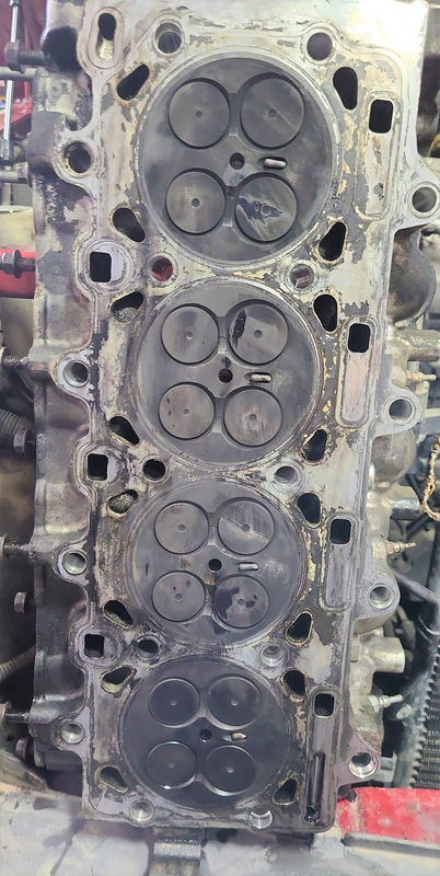

Does anyone know what the cylinder head resurface tolerance is by chance?
 Post subject: Re: 05 CRD Running Rough...Throwing Several Codes
PostPosted: Wed Nov 16, 2022 11:09 pm
Posts: 7387
Straight from the Factory Service Manual: "The cylinder head itself is not resurfacable."
The minimum cylinder head thickness is 89.95mm (3.541 in.)
Do not have the head milled - there isn't enough extra material (thickness) in the head to perform machining.
The head comes from the factory with a thin nickel coating on the head gasket mating surface, so if you machine the head it will remove this coating.
Also removing (machining) any material from the head can also create clearance issues between the top of the piston and the valves.
This is an "interference" engine and clearances are already really close.
The picture below shows just how close the valves are to the sealing surface.
