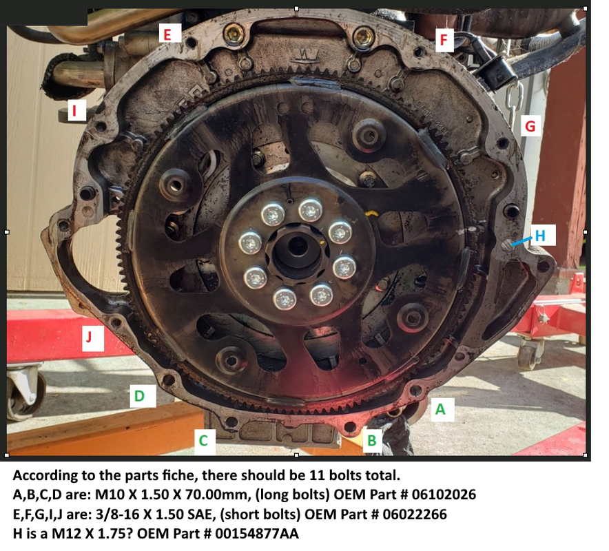

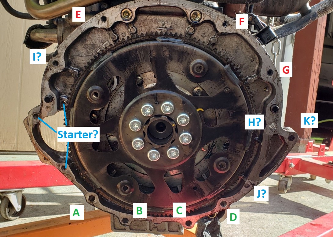

Finally took the dive on this large project to replace the tranny oil pump, upgrade the valves or whatever, and new TC.
I am having trouble figuring out which sets of bolts are on the bell housing. I haven't tried that hard but wondering your thoughts. There seems to be two sets or an adaptor plate looking thing, it's just hard to tell.
I can find ZERO info or guide on how to get this sensored word out. Everything online is for the gas lol. I got the TC bolts off, everything else but cooler lines, and I'm about to try the bell housing bolts. One looks near impossible to get to against body molding and a sensor. I can remove or unplug sensor but don't know if I need that out. I got tranny jack and all the goodies to make this easier and am pretty familiar with mechanical things.
If anyone has any pic or diagram of bolts needed out would help. I looked in FSM and it's junk. Doesn't even match my jeep really. The pics and descriptions are for gas or something. It talks about removing exhaust pipes and stuff but it didn't even match what I have. I may have to remove it to access a bell housing bolt though, but hoping not. If anyone has some tips send em my way ;)
Trial and error I guess?
Thanks!

Maybe these will be of some help to you? :wink:

Extremely helpful. Let me give it a shot. FSM didn’t even have these pics.
Thanks!

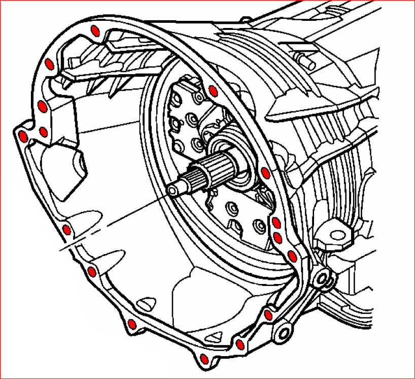

Found a couple more that may be of help. Enhanced one of them for 2.8. First one shows a slightly different model engine, but the mounting is the same.

I guess that is only showing the top bolts? I did see that sneaky reverse direction bolt.
The FSM speaks to a engine / transmission lower collar that I haven’t found on mine. Maybe that’s for the 3.7 gas. And for that one that was how it said to access the TC bolts not through the rubber cover above starter. But it was the cover on mine.
They also said turn the crank bolt on harmonic balancer. That’s impossible without removing fan or a special low profile tool maybe. Or maybe the GM Superfan we have makes it harder. I was able to turn engine slowly and tediously with beer and flat blade through the starter hole. :)
What is the torque on those TC bolts? And someone recommended using blue loctite ?

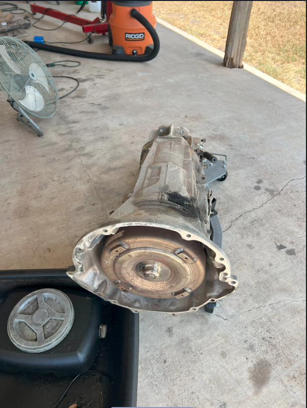

I did finally get the beast out. It was surprisingly easy, just requiring lots of patience of course. Some points, as I have found VERY little info on this job on this vehicle:
1. All the top bolts are easily accessible by fully lowering the transmission, I just more less let it rest on the engine mounts, leaving a small gap on the front cross member there.
2. There are two reverse facing bolts at the bottom of bell housing. And one additional one near the exhaust. It was indeed trapped behind exhaust and hard to get to but I just used a 16mm wrench and back it out and let it hang there, away from bell housing threads.
3. I broke the bolt holding the tranny oil dipstick, completely rusted. And there was two additional bolts missing. That's concerning, now I know this thing has been out before and who knows who did what to it. I'll take a look at pan magnet thing to see if any shavings. The fluid smelled kind of burnt and nasty but not sure normal smell lol.
4. No splines to deal with, I guess I'm used to manuals. Just lowered out once unbolted and cleared a little. Be careful with wiring one wire loom was fastened to transmission up high; that won't go back in :D.
5. Don't leave engine hanging, support it with scissor jack while work. This has been a spread out project for me as I find time, and the hellish Texas heat doesn't help anything. I worked all night on it.
I'll try to get more bolts or at least get the frozen one out if I can and replace it. It was also hard to get the thing out from under jeep I had to lift entire back in way up high, worrying about front end jack stands and stuff falling off, but they didn't lol. I have a couple extra safety jacks around.
https://yourimageshare.com/ib/5gEsCZSl3y
Don't know why google drive public link for the image isn't working. Tried another site, doesn't work, something wrong with forum code
