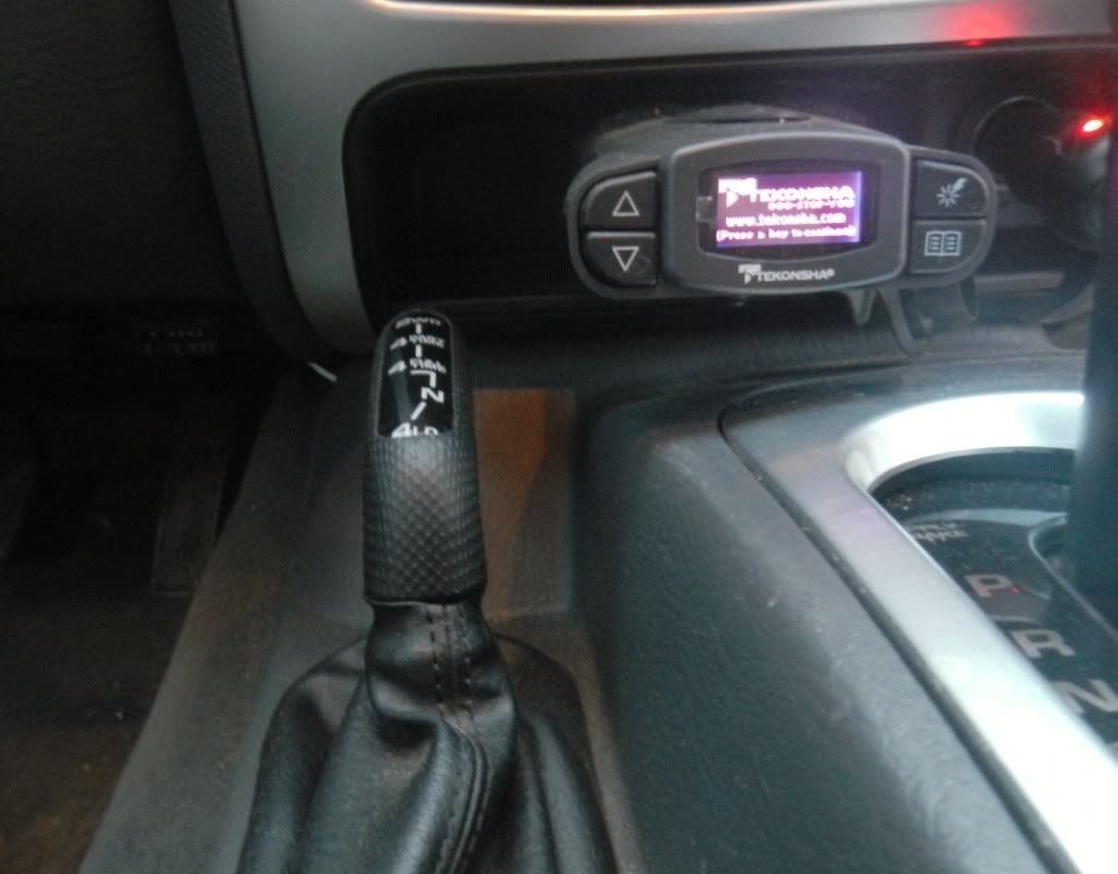

There are some great threads here on Lost expalining how to hook one up. The hardest part in our Jeeps is finding a place to put it.
Put mine in the pocket under the controls:
This trailer with its big frontal area is more difficult to tow with than any cars i have hauled:

Like this:
These make an amazing difference in safety and handling. I've used them on much larger trailers, but I sold mine before the CRD came along... Will be buying another one for pulling the enclosed trailer!
Ditto on the pocket...
but I went a different route on the brake controller. MaxBrake hydraulic over electric. Ironically it fits exactly into the pocket. And I agree, the frontal area of what your towing will make far more of a difference than anything else.
