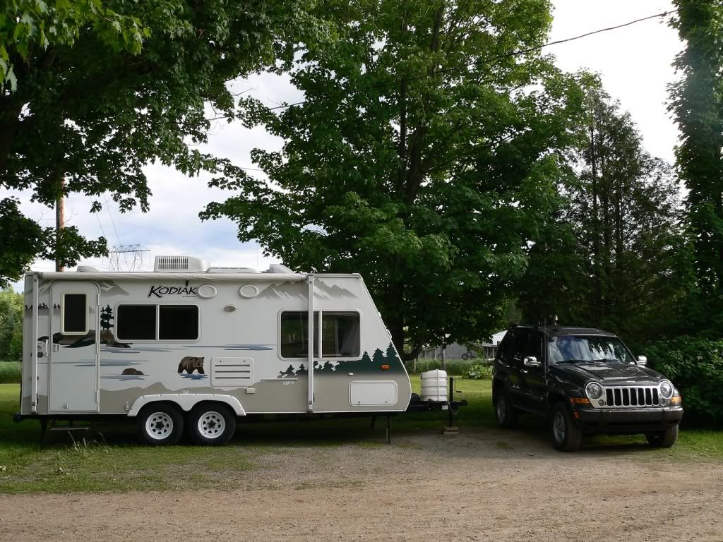

I have a 20 foot travel trailer. I got the sway and weight hitch and trailer brakes. My problem is when I get a side wind of 20 or more the truck feels soft in the rear. It feels like it gets light in the rear tires.
I was wanting so suggestions on some spring and shocks for the rear .

I'm at 152000 miles has the stock shocks and springs. I getting so sagging in the front. I have a weight and sway hitch. Trailer breaks on the trailer. It really does pretty well. But when the wind is blowing or big trucks pass me. I feels light or soft in the rear of the truck. I have 600 pound bars on the hitch. I have adjusted it a few times. Its the best I had so far so trail and error.
The trailer dry weight is 3003 pounds. I might have 500 pounds of gear. I never carry water or sewer water . Or at least not yet any way.
I think the stock shocks and springs are just done. I'm really not wanting to lift the jeep it's main roll is towing . Thanks for all the help.
