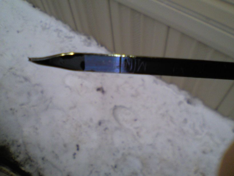

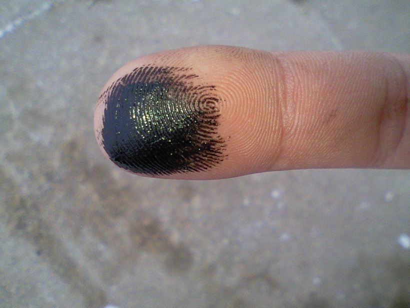

Bit of a update, I checked my oil level. But my oil light did NOT come on.
and this is from sticking my finger up the tail pipe.
Phil
 Post subject: Re: I Think My Turbo Went Out The Door Tonight.
PostPosted: Fri Dec 28, 2012 12:31 pm
Posts: 6302
Nice fingerprint capture, CSI Stokes... :goink:
I dont like that dipstick level, that looks to be at least 3 quarts down, which does strongly suggest that your turbo ate it. Hopefully you haven't lost enough pressure or oil level to have damaged the bottom end bearings.
You still need to pull off all the hoses and have a poke into the front-facing turbo inlet to check the play. I'm going to figure that what you find will be more than "none" on the play scale. If / when you start looking for another turbo, find your local diesel injector repair shop, they will most likely be a Bosch shop in the heavy truck / industrial areas of town, and they will probably also be a Garrett distributor. These turbos should be about $1100 from one of the distributors, and there are NO official rebuilds (you don't want one anyway) and no core for the old one. If you hear either of those words from the seller, walk away. You don't know what they are selling, but it won't be a brand-new Garrett.

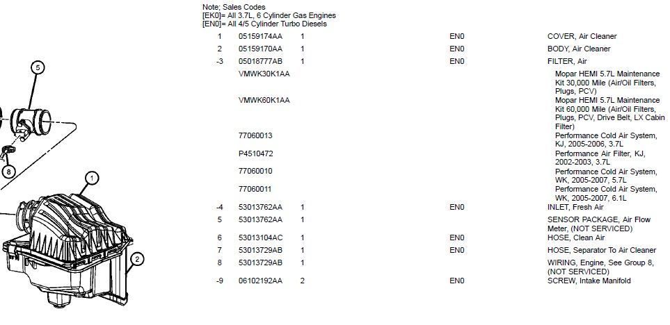

Today I had some time to get the hoses out and inspect them. After cleaning them in the sink (don't tell my girlfriend) I inspected them and they appear to be in good shape. I was not able to find any holes or tears in them.

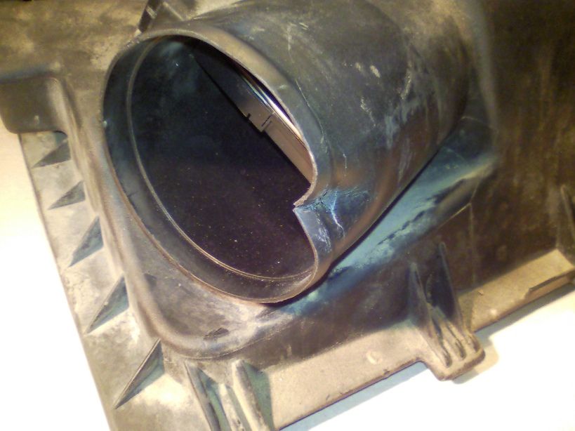

However when taking the clean air hose from the air box, I did discoverer this:
When comparing my air box lid to the one in the micro fiche, they appear to be different.
This leaves me with a few questions.
Is the part number in the micro fiche the correct one I need?
and much more importantly,
When reading the directions to replace a turbo from the factory service manual, it time consuming. Does any one have a step by step on how to do this and a time estimate?
Phil
PostPosted: Mon Dec 31, 2012 2:49 am
Posts: 6302
Rule #1... When in doubt, the FSM is wrong.
Your airbox is correct, but that damage is what happens when the airhose isn't all the way on and touching the MAF, and / or the hose clamp is gorilla'd when you tighten that clamp. Been there, broke that. Drove with it cracked for many many miles, wrapped badly in tape.
Now, on to the turbo swap. You might want to contact Papaindigo to see if he has a document outlining the procedure we followed for turbo removal in prep for the upgrade to the GDE turbo. Obviously you would not be doing the second half of the directions, but the removal parts would be quite helpful for you right now. In reference to your questions, refer to rule #1 frequently. You do NOT have to drain the AC or the radiator... Or start by removing the rear seats and all the tires from every vehicle in the area. I think the FSM adds in useless steps to everything as a way of punishing us for ever buying something they clearly did not want to sell or support. :banghead:
Anyway - Once the airbox and the air hoses are out of the engine, the next thing will be to unbolt the radiator bottle from the firewall. Don't unhook any hoses yet (or ever, for most of them) but flip the bottle on its end toward the passenger fender. There will be some maneuvering with this thing as you go, but the only line you might want / need to unhook from it (just to reposition it) is the smaller overflow hose that (IIRC) comes from the upper left (passenger) side of the bottle, and snakes under some of the AC stuff. Unhook it from the bottle, clear it from the obstructions, and put it back on. That finishes your work with that, save for pushing it around as needed. For a time estimate... I can do it now probably in about 3 hours (2 hours flat was my fastest time, but that was on my own 'not-everything-stock' engine) but you are probably looking at 5 hours for the whole job. It isn't terribly complex... Just tedious.
The directions from GDE / Papaindigo will be more help, and I'm also available for tech questions if you have any. When you PM Papaindgo, he can give you my number - I'd do it now but my laptop is just about out of power and so am I for tonight. :lol: Good luck, catch up with this as it progresses.

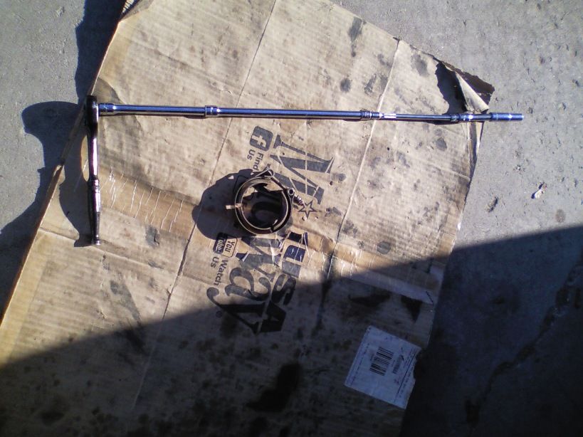

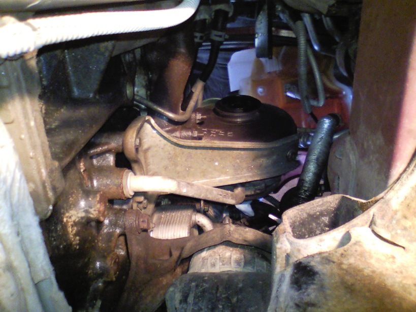

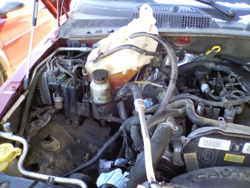

I spent some time today getting more taken apart while waiting for the turbo. I sprayed all the bolts/nuts on the turbo with some PB Blaster and probably will add some more tomorrow too.
This is what I used to get the exhaust clamp off, from the bottom up.
And how far do you get the coolant bottle to tip, this is what I felt comfortable doing with out straining much.
Phil

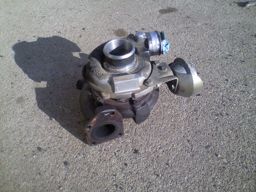

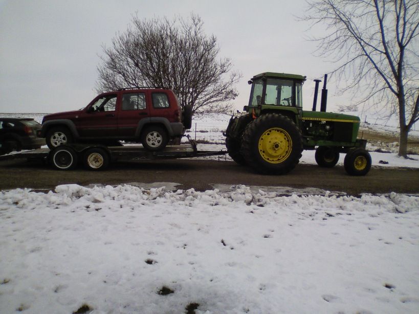

I towed the jeep to my parents garage today and was able to get the old turbo off. I live about 3/4 of a mile from them, here is how we towed it.
I pulled the exhaust off by unbolting between the muffler and the catalytic converter and lowered the transmission cross-member. This is how I was able to get the exhaust pipe out of the way to open up lots of room.
From there I did almost all of the work from under the jeep. I removed the turbo Bracket, then the oil return line. Then I undid the banjo bolt up top, and started to undo the bolts that hold the turbo to the exhaust manifold. They were stubborn to remove but I did not have any of the nuts bring the studs out with them.
All that remains is for me up my to pick my new turbo up tomorrow (if it comes in), install it, drain what oil is left in the engine, refill it and drive. :)
The only question I have is, since I did not take the turbo oil feed line off of the block, do I need to remove it and clean it, or should I just leave it there?
Phil

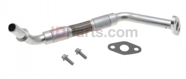

I did get my new turbo today, but it did not come with any gaskets. When I was there he said he ordered a oil return gasket today and it will be there tomorrow. I also cleaned the feed and the return lines inside and out today.
I also have a few more questions.

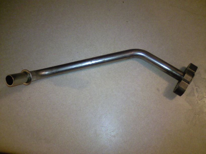

This is my oil return,
and this is the one pictured on idparts http://www.idparts.com/catalog/product_info.php?cPath=117&products_id=3208
Also on idparts, it is mentioned of crush washers on the engine side. http://www.idparts.com/catalog/product_info.php?cPath=117&products_id=3209
1. Is there any advantage of having a oil return that has a flexible section?
2. The description mentions crush washers on the engine side, I did not see those on mine, are they not pictured in the image above?
3. Is the gasket that goes between the exhaust manifold and the turbo reusable? (If it appears to be in good shape)
Phil
PostPosted: Tue Jan 08, 2013 9:23 am
Posts: 5431
1. The turbo bolts to the engine and only moves to the extent the engine moves on the engine mounts hence I don't, offhand, see any particular benefit to a flex section in the oil return line and I honestly don't recall (it's boxed up but I can look if you want, drop me a PM/email if you do want) if my OEM return line was solid or not. I do know the GDE Stage II turbo oil return line has a flex section. So is there a benefit or not - IMHO not much if any but will it hurt no so if your existing return line is solid and clean internally I don't think the extra $s are worth it. FYI when the engine flexes the exhaust system, which is connected to the turbo flexes hence the flex section needs to stay in the exhaust system again IMHO.
2. The IDParts description has a "opps". The 2 copper crush washers go on the turbo side-1 on each side of the banjo bolt connections of the oil feed line to the turbo. The engine side connection is an odd round fitting that mates with a fitting on the upper oil gallery of the block and is friction sealed using a nut on that fitting. The washers do show, barely, in the picture - look closely below the right end of the fitting.
3. gasket can probably be reused but after all that work and $s why try to save ca. $20?

The biggest difference between the flexible oil return line and rigid one, is that the flange on top of the rigid one can slide down the tube as you are trying to install it, and will annoy the hell out of you. :furious: But the flexible line has a fixed flange on top.
Phil

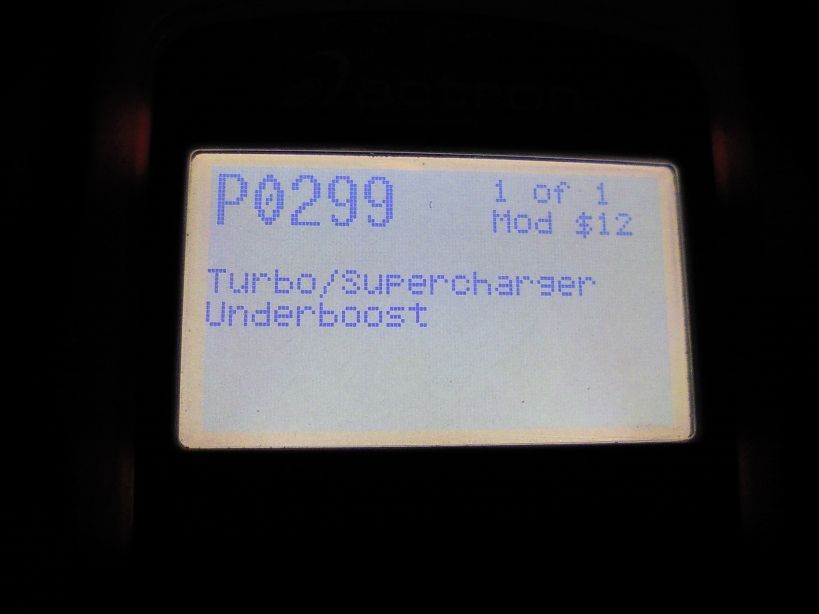

I went for a 25 mile drive tonight to check everything out and to make sure it is working well. It ran really well and didn't go through a quart of oil in 2 minutes. :roll:
However while driving up a long steep hill and the Check Engine Light came on. I will borrow a scanner from a friend soon to see what the code is... :POPCORN:
Phil
PostPosted: Sat Jan 12, 2013 3:14 am
Posts: 324
Location: Dubuque, IA
Here is the code I got. I will pull the two CAC hoses and clean the map sensor. I wonder if one of them burst since installing the turbo.
Phil
