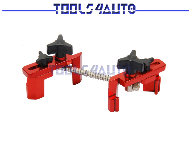

Found this tool on Ebay not sure if it would work...
Looks similar to what Sir Sam postedImage
Link to the thread where Sir Sam Posted http://www.lostjeeps.com/forum/phpBB3/viewtopic.php?f=5&t=72959&p=766094#p766094
