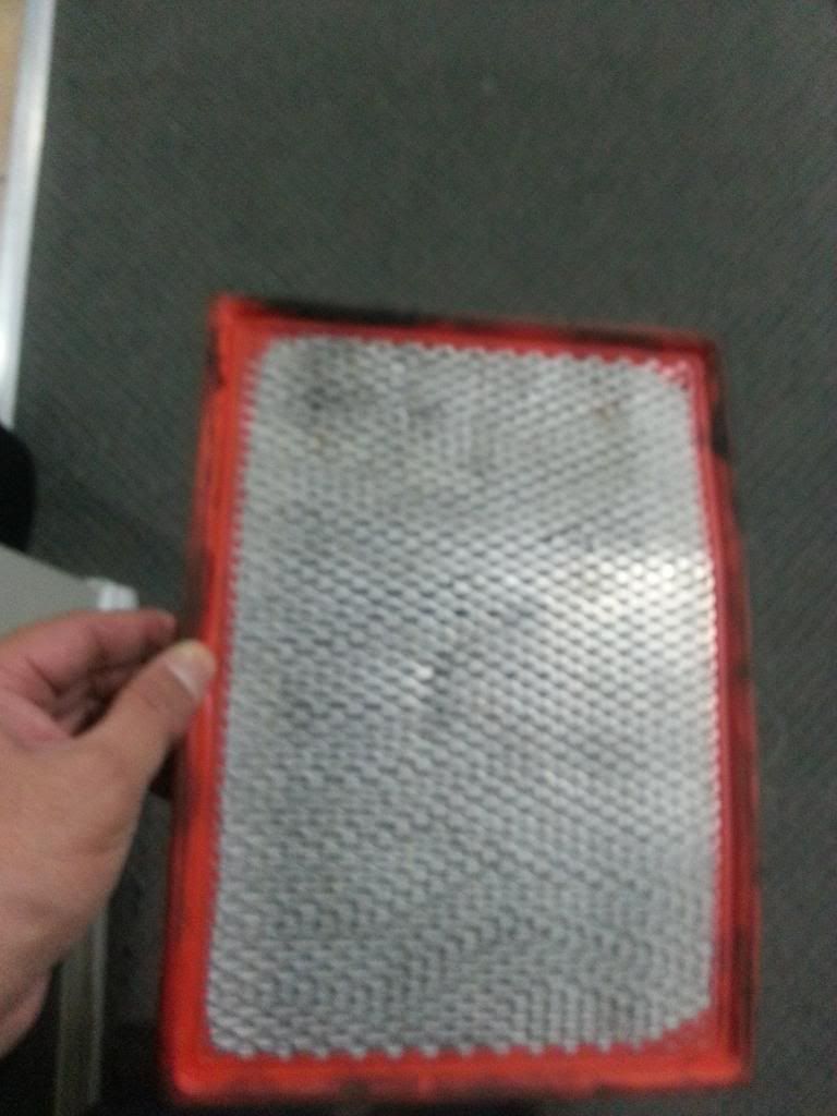

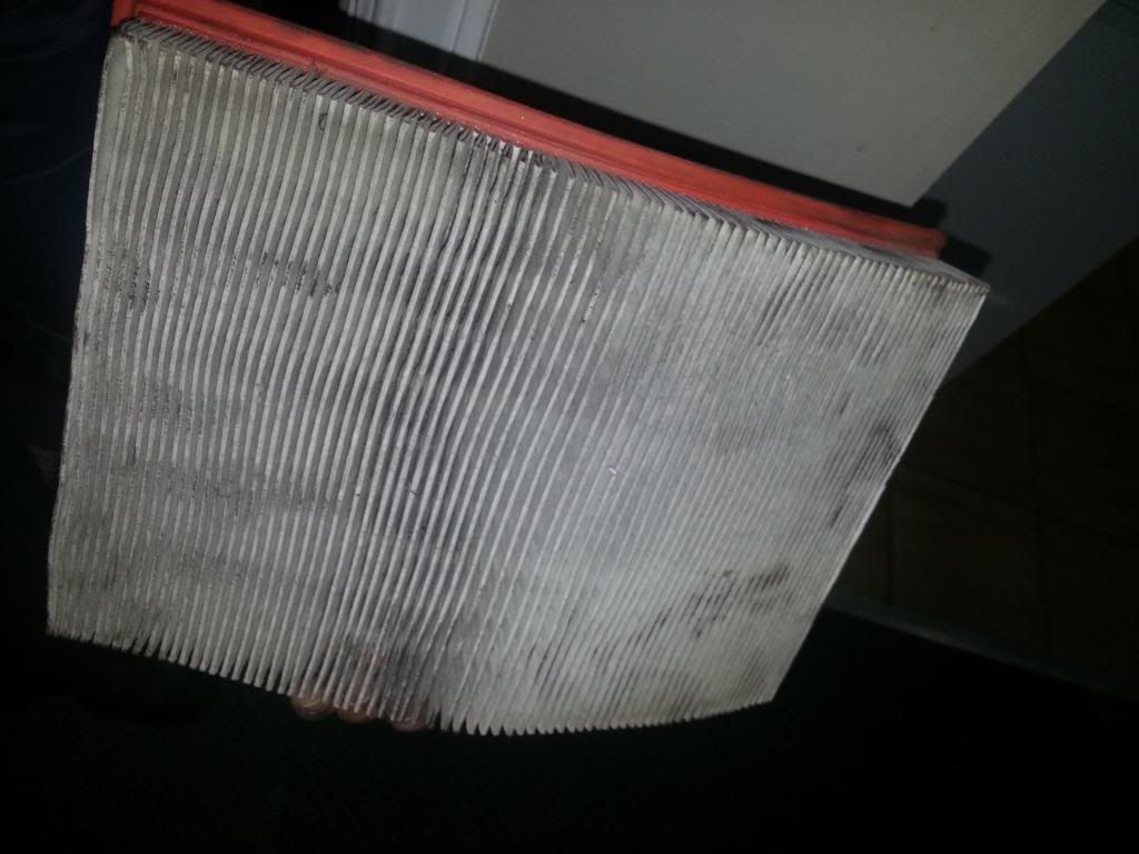

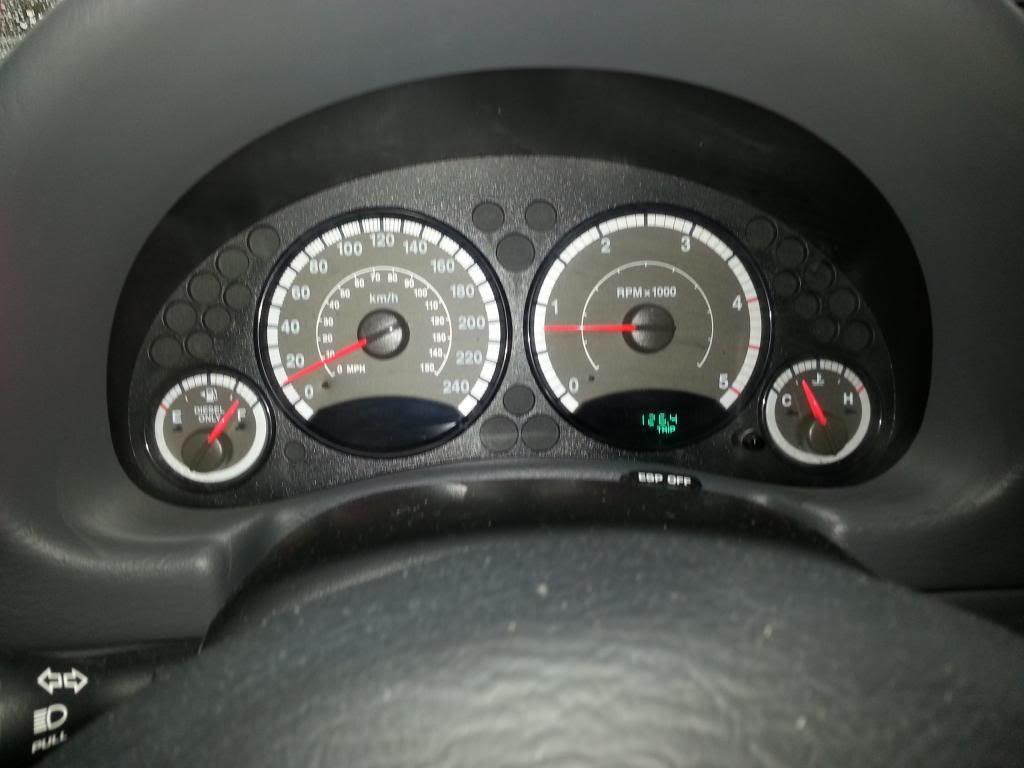

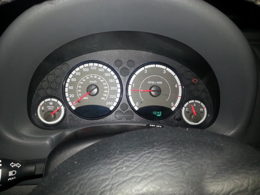

hi i recently got myself a CRD liberty 06 with 161k KMs or 100K miles so i have ordered the parts and will get the timing belt replaced this Thursday. So far my mileage is very poor and as such i am inviting feedback on that, with winter fuel and pacific north west rain at 45 degree temp i got 231miles (interstate 5) out of 13 gallons so 17.7 , i did not clean the sensor and have taken pictures of air filter so advice me next course of action.
Second issue bamboozling me is the CEL light it has a mind of its own it shows up and then vanishes a buddy tried to get the codes by his reader nothing showed up. PO had at one point taken it to stealer in the summer and the stealer fished these codes P0670, P0201 and P0299., but nothing was done as stealer wanted 842 bucks plus taxes to replace EGR.
After TB service i intend to clean MAF or MaP sensor and put new air filter that should take care of MPG till i can shell out GDE eco tune and regarding EGR i am clueless as a coupe of shops have tried cleaning the gunk and the codes but no dice so far.
CEL on
CEL gone
Air filter
Is it time to replace? i wanted to hold on till next week and get a K&N i guess i have to do it sooner than later.

Posts: 5171
K&N's are very bad if you want to keep the engine.
They let in more air and more dirt.

A dirty air filter can cost mileage, but I wouldn't us a K&N either. Any filter you can see daylight through is not going in my engine bay.
Also, is that your normal operating temperature when driving? Looks like your thermostat is opening too early which can cost mileage because the viscous heater will run almost continuously.

This was the normal temperature in the pictures after driving for couple of blocks to run errands, I have not seen the needle go any higher on freeway runs either.
Now do you think filter needs to be replaced and if so which one ? How about Wix? thanks for your inputs.

As was mentioned earlier, your thermostat is bad based on your pic and description. Lots of people use the Wix (Napa) filter.

From personal experience with failed by opening too early OEM tstat with the temp gauge sitting just slightly higher in 30-50F weather I lost right about 10% in mpg. That dirty filter probably isn't helping either just spring for a standard Wix or NAPA paper filter.

As others have already said, it is running way too cool, and that will rob the mileage for the previously mentioned reasons. Either replace the tstat or put an inline tstat. As for air filters, a good one, such as a Napa Gold (Wix) would be good. I have used Purolator, Fram (their air filters are alright, but I stay away from their oil filters), and Napa Gold. I prefer the Napa Gold air filters myself.

yup it was the thermostat as pointed by all got that replaced along with timing belt and water pump. New wix air filter is also installed.

I always heard that KN was the way to go....and specific reasons why not?

Not recommended by the tech or the peeps at this forum.

Thanks....will go napa this weekend. Mine came with the k&n already installed.

This has been posted before but tends to get lost
http://www.dieselbombers.com/chevrolet-gmc-diesel-tech-articles/16611-duramax-air-filter-testing.html#post214366
