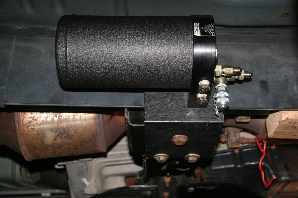

I know some have already done it, and I know there's more than one way to go about doing it.....
Some have installed them under the hood, others have installed them in the undercarriage..
What is everyone's thoughts on this? Does anyone have pics of their bypass filter installs? let's see em'.

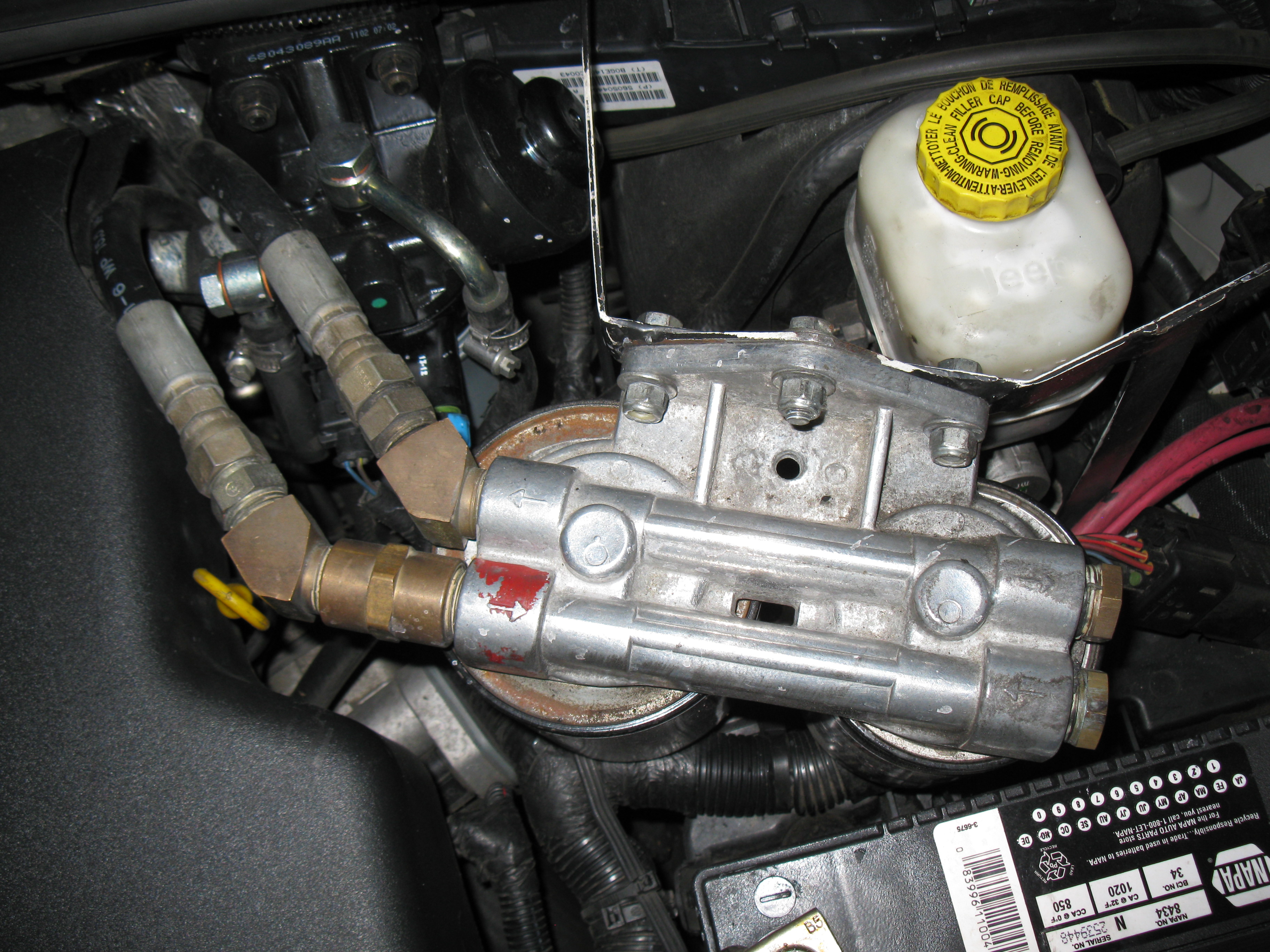

This is a 1st generation Amsoil unit I had laying around when we got the '05 CRD in 2007 and installed it right after we got the vehicle.

let me guess, your turbo, valvetrain and bottom end are all in fantastic shape, right?
If you could do it all over again, would you still install your filters under the hood like you did?
I'm thinking about going off a frame rail with this kit....

92K on the Liberty CRD and so far no signs of mechanical or turbo problems. I will be doing the TB replacement in the spring or early summer.
I personally like the filter mount under the hood...stays clean and no chance for road hazards to damage the filters. Also it is convenient when changing filter elements. The only issue on many vehicles is finding a place to mount the unit and when you do find room, you will have to construct a bracket of some sort. As you can see in my pictures, I built a mount from 1"x1/8" steel and bolted it to the firewall using existing bolts along with a vertical support to the fenderwell. A plate was welded to the 1" frame to bolt the filter mount to.
