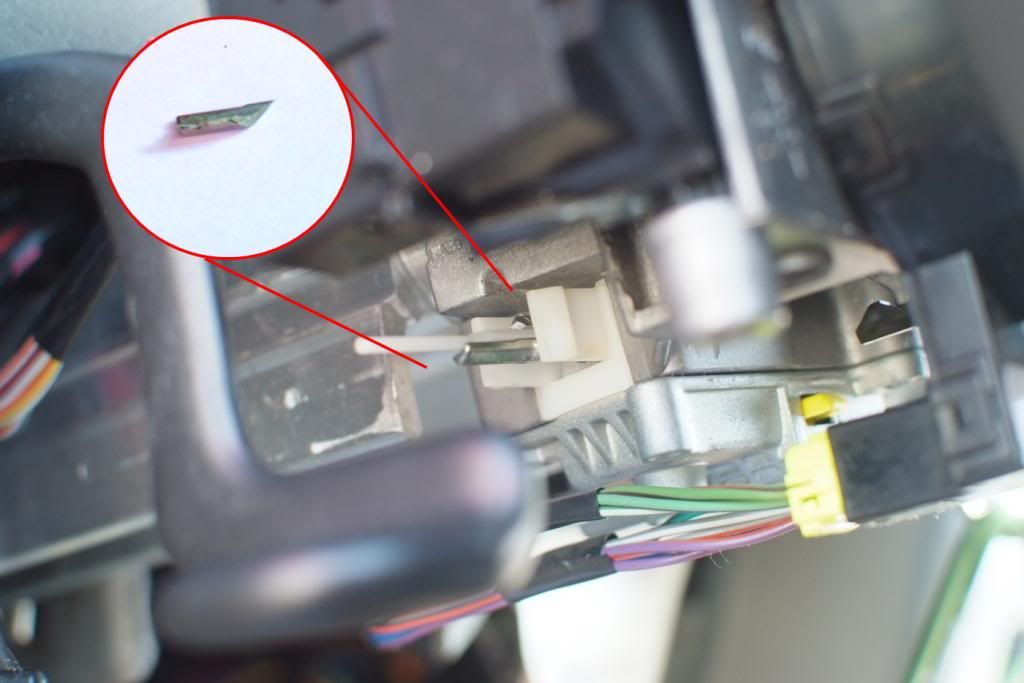

I just had mine refuse to crank, as in no power to the starter, saturday morning. Battery is new, ditto alternator, put a volt meter on it, 12.2 volts until you turn the key, then it drops to 11.8 volts, and makes no sounds, holding 11.8 volts when you try to crank it. Turns out to be a little tiny tang that sticks out the back of the ignition switch broke off.
The part is $68 from the dealer.
This would have noting to do with the OP's original problem, but might be related to to the subsequent no-crank condition.

If by a "tang" you mean the rod from the key switch on the right side of the steering column that engages the ignition switch on the left side of the steering column a Dorman replacement (PN 924704) runs ca. $27 and there is a good how to install video at http://www.dormanproducts.com/p-45278-924-704.aspx

replaced the ignition switch actuator part from dorman and eliminated the stalling problem

Glad I saw this. Happened to me too. Dealer quoted $1200 for new steering column. And it's backorderred.
I'm getting one from Autozone today and tomorrow the dealer will get a little visit.

danoid - not a bad deal for the dealer especially if all they "really" do for that $1,200 quote is replace the $30 part.
Just to get it out there see viewtopic.php?f=5&t=61233&p=678574&hilit=+brother#p678574 for diagnosis on a bad actuator pin or bad ignition switch (driver side of steering column) neither of which is an expensive part.
Also don't forget the shift interlock that prevents starting in gear. About that geordi says "Pull the shield off the top of the gear shifter, there are 2 small cables in there; the passenger-side one is the sensor cable, it's not electrical, it's an aircraft wire; the sensor is actually located under the steering wheel. Unhooked, problem solved permanently. I thought of a quick way to test the actuator cable without pulling anything apart on the shifter console - With the engine off and in park, pull back slightly on the shifter to apply tension, and try cranking the engine. If it doesn't go... The cable is the culprit b/c the tolerance (and how much it moves normally) isn't much. The cable is pushed toward the front of the vehicle when the selector is in park, and just shifts backwards slightly when the selector is anywhere else. All you need to do is unclip the end of the cable, and push the end into the sheath until it stops (about 1/4") and tuck it away in there. This won't affect anything else in the operation of your CRD, the shift interlock (that foot-on-brake-to-shift) idiot switch will still be there and functioning... Unless that 2-wire connector happens to "fall out" like it did on mine. Strange how that happens sometimes. "
