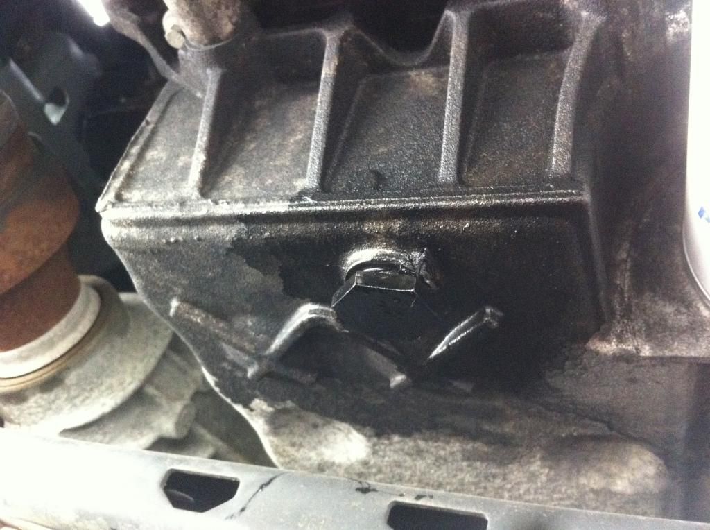

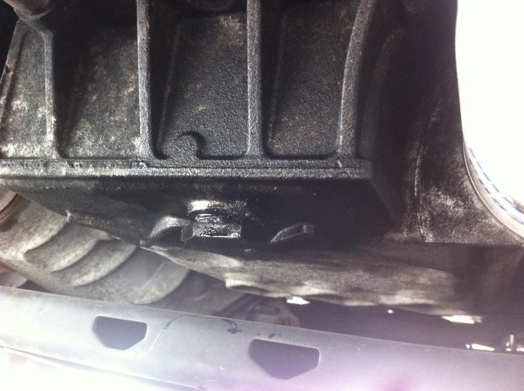

First of all hello, sorry to make my first post a cry for help. Been lurking for awhile and recently picked up a CRD. Doing the first oil change today I noticed the drain plug wasn't the usually hex style. Then when I started to remove it saw that it was coming out quite lopsided. I'm guessing the previous owner ruined the original threads and shoved in an oversized plug. I immediately stopped removing the plug because I fear it might not go back on. So now I have a few questions:
-Will it be possible to drain the oil by simply removing the oil filter?
-What are the recommended ways or fixing this? (Rethread the oil pan?)

Ya, that sux. No, it won't drain the pan dropping the oil filter. Only option for repairing the threads is a helicoil. Other option is a new pan. You could possibly have a threaded boss welded in, but cast aluminum welds like crap and any cast metal is very porous and soaks up oil, making it that much worse. Aluminum is particular about the way it's welded. I have a just a few posts on this forum, but I Work for caterpillar. I'm around engines daily.

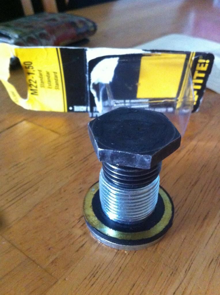

Got the heli-coil kit. Took my plug out and found that the pan was re-taped by previous owner. It looks like they didn't make it very straight tho and so they used Teflon to stop the leak.
The size they used was even bigger than the repair kit. Image
So for now I added a washer and fresh Teflon, and plan on retaping the pan on the next oil change. Only plug I could find bigger was this 22mm.

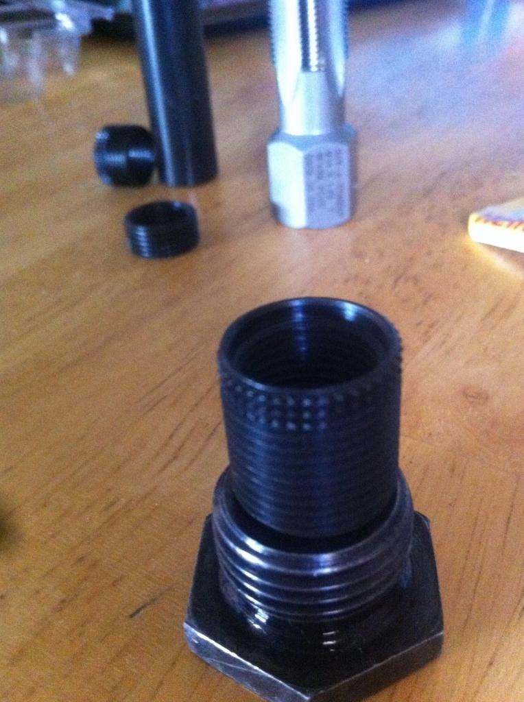

FOund the same thing with the truck I just purchased...Tapped it from the M16 to m18 thread and installed a grainger no spill drain kit...Not that much bigger then the original plug, and relatively cheap

It is not clear to me how that plug works. Is there more to it than just the knurled cap?
