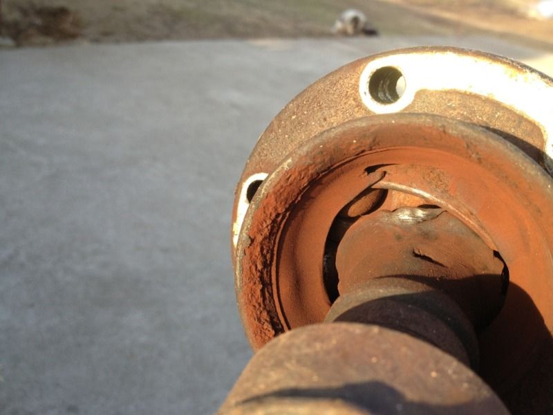

Well my front drive shaft is wasted and removed and wondering if it is too wasted for a rebuild kit?
Anyone know of any writeups on the rebuild?
Are the CRD driveshafts the same as a gas jeep?

Pack it full of grease and put it back in! :-)r
I personally would replace that. That's pretty bad.

was thinking this...
http://www.driveshaftparts.com/cv-joints-shafts/jeep-front-driveshaft-cv-joint/prod_430.html

That looks pretty simple/straight forward. I haven't fooled with one on the Jeep, but it looks like a simple CV assembly on a splined shaft. Looks like an easy fix. Price is right too. I would do it as long as the splines are fine on the axle.
Billy

that is who I used , and mine was worst , you do not need a new shaft

Good to know, thanks... looks like it is just spline, I'll give it a shot.
