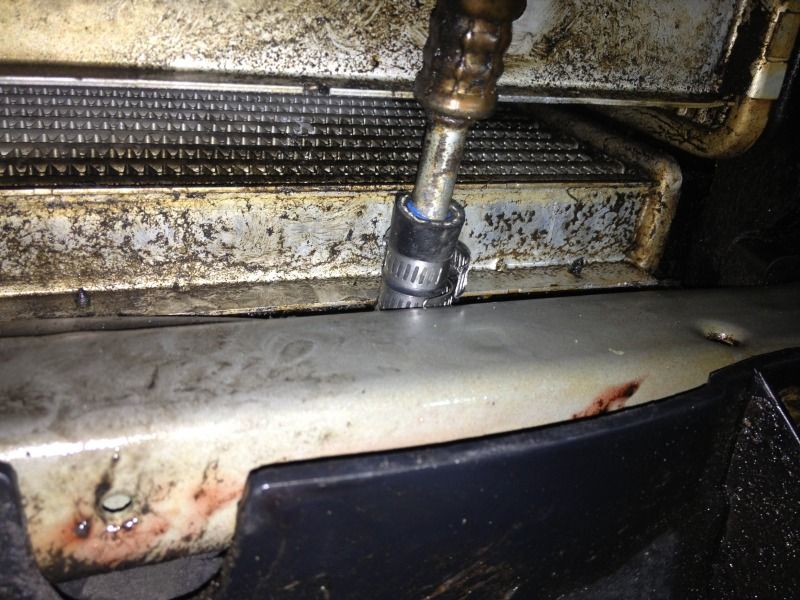

I have a bunch of nasty gunk at the bottom of the condenser/ trans cooler. From what I understand the bottom I the condenser is the trans cooler?
Is this a common leak point? After a trans filter and flush I have been filling it up slowly as you know it is fun to check fluid right afte adding.
Today I noticed a bunch of trans fluid soaking the underside of the jeep in the very front.
Any ideas?Image

The bottom of the AC condensor is transmission oil cooler. Both the in/out lines have a fitting that's retained by some sort of clip, I've not seen it but there have been posts on those fittings; the fittings can leak and I think but am not sure that there are aftermarket replacements. A tranny shop could probably tell you. It's also possible for the cooler itself to leak.
I'd suggest clean the area up with something like engine degreaser and then attempt to locate the actual source of the leak preferably without driving as blowing air can move that fluid all over the place. You might want to see if there is a ATF+4 compatable UV dye that could be used to quickly spot the leak.
If it's the condensor that's leaking the dealer fix is a new condensor or the DIY fix is cut that cooler out of the system and install an aftermarket cooler behind the grill. Run a search of my recent posts for links to several aftermarket installs.

Yeah I just got done with the hose and some degreaser, I guess I will let it idle for a while and see what I can see. They was going to be my next question, the aftermarket cooler ha. Just didn't know it it was a simple fix, such as a seal and a new clip or what not.

I seem to recall, could be wrong, some posts to the effect that the fittings can be removed/cleaned and reinstalled with some success. I did poke around at one point for repair kits but not enough to be sure I found something although a good parts store like NAPA or a good local tranny shop might be helpful. If it's the lines/fittings from what I've seen the dealers want to replace the whole line.
See viewtopic.php?f=5&t=75368&p=792909&hilit=cooler#p792909 for aftermarket cooler install links.

Papaindigo nailed it again, best is to clean and then look. If its a small leak, it may take you several miles to notice it. It could also be from the steering fluid, that could leak from somewhere, its a pain to track it with all the stuff cramped over there, so cleaning everything in the area is the best thing you can do so far. [Edit: doesn't look like being power steering fluid, just looked at the pic from the computer, when I replied I had the smartphone.] You could also have a hole in the intercooler (doubtful looking at your pic) and some oil blowing through that hole in your cooler.

These lines typically leak by the 100K mark. You can replace with OEM as we did under warranty at a dealer not long ago, or engineer a longer lasting aftermarket solution with aeroquip lines.

I think i found my heavy leak that was soaking the underside of the jeep, and unless something was re-installed wrong by someone else in the past this is another thing that should be fixed with preventive maintenance in mind! it looks like it was factory wrapped with some type of protective material to prevent this but it wore right though. The pass side cooler line on the inside of the core support rub on the support and I had a pin hole that was spraying fluid with a steady stream at idle, I would hate to see it while moving ! She has to drive it to work tomorrow so I rigged it up with a piece of heater hose and a little silicone with some hose clamps nice an tight. Not sure if the patch will hold, I hope it does. On the plus side if this leak is the cause of the darn drain-back and trans acting like a manual on a cold start that would be a plus!
Now I just have to decide if i want to try and replace the line with OEM or cut them and go aftermarket. how much pressure are we talking about in the lines, can I get away with cutting and hose clamping on a flexible line to an aftermarket cooler? I don't tow a lot so I don't need anything like thermorex that's for sure!!!
Both sides were rubbing I suggest everyone check out their line and maybe prevent this with a piece of heater hose or maybe even a few zip-ties!
