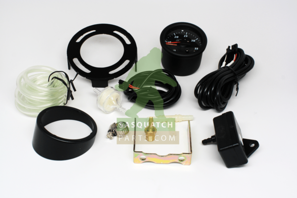

The Sasquatch kit is very nice because it comes with everything you need.
I bought from Amazon a VDO 0-30psi mechanical boost gauge. It required me to make my own bracket for mounting on the dash and it works very well.
The hard part about installing a boost gauge is drilling the hole for attaching the fitting. Some folks have drilled directly into the intake manifold and tapped the threads for the fitting.
I chose to drill into the weeks elbow because its thinner aluminum.
Not as clean of an install as some others because I didn't have a thread tap, but I made it work.
U.S. Army Retired

The CAC endtank is probably the easiest place to drill and tap for the sensor. The plastic is nice and thick in this spot:
SasquatchParts.com

This is the drill and tap you need - https://shop.sasquatchparts.com/product ... it-18-npt/
1 - Mark where you plan to drill the hole
2 - Remove the CAC hose from the CAC outlet
3 - Insert shop vac. into CAC outlet to suck up the plastic shards. Add duct tape to secure in place.
4 - Using the drill bit, drill your hole
5 - Using the tap, create the threads
6 - Install the included hose barb - DO NOT OVERTIGHTEN
7 - All done! Finish boost gauge installation...

Possibly. Even if boost pressure is the same, the flow rate is certainly less if there is a restriction, which will indeed have performance implications.

mass-hole wrote:
I was hoping it was for testing a performance CAC :BANANA:
We looked into it. No room to work with, and non-standard core size made it pricey to produce. I am not opposed to the idea, but if we did one, it would be a limited production run. Pre-orders only, and would need a minimum number of orders to make it happen.
