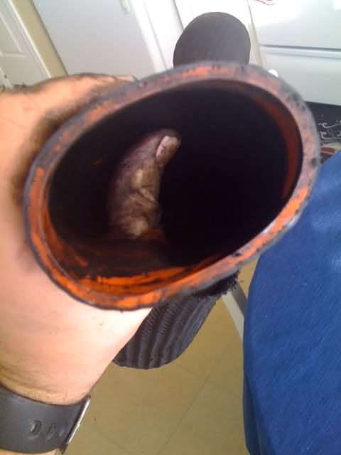

If your intercooler hose burst it will idle fine, and probably drive ok. Mine would even run down the interstate with a 2" split in the driver's side hose. Only getting on it, like an on ramp did it have low power and tons of black smoke. If you took the hoses off and rolled them in your hands looking for splits, I don't think you would have missed it. My first thought is that the timing belt skipped time, or like mentioned before the MAP sensor suddenly died or is plugged up.

Definitely doesn't sound like a boost hose. Similar to CATCRD, I had a split in my driver's side boost hose that was big enough to put my thumb in:
Even with this split my CRD would start and idle fine. It would even drive but I would have to take my time getting up to speed. It would build some boost and then "whoooosh" out and lose some power. I would have to keep going through that cycle until I got up to speed. I was actually able to drive it about 85 miles or so to get it home like that.
