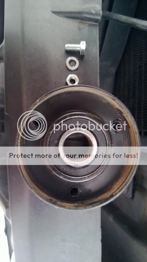

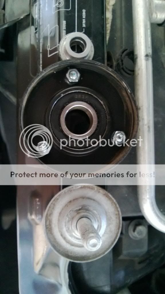

just go to any auto parts store and get a 203 bearing, then go to ace hardware and get 3 M5-8 bolts, 3 M5 lock washers, 3 M5 nuts, and a small tube of blue thread lock. it should not cost more than 10 bucks.
All you need to do then is remove the idler rivets (3) with a 4mm punch and a hammer, split the idler apart, replace the bearing, install the M5 bolts with thread lock in place of the rivets, let cure for an hour or two, and install the idler back again. It should be as good as new.
I'll try to post pics later.

Thanks for the info! Unfortunately, I already ordered the idlers this morning before you posted. Total cost of 6 with shipping was $167.78 ($27.96 each). I can rebuild my old ones using your info and use them on my other two Jeeps for a fraction of the cost (Advance Auto sells that 203 bearing for $12.09 each). Thanks again.
